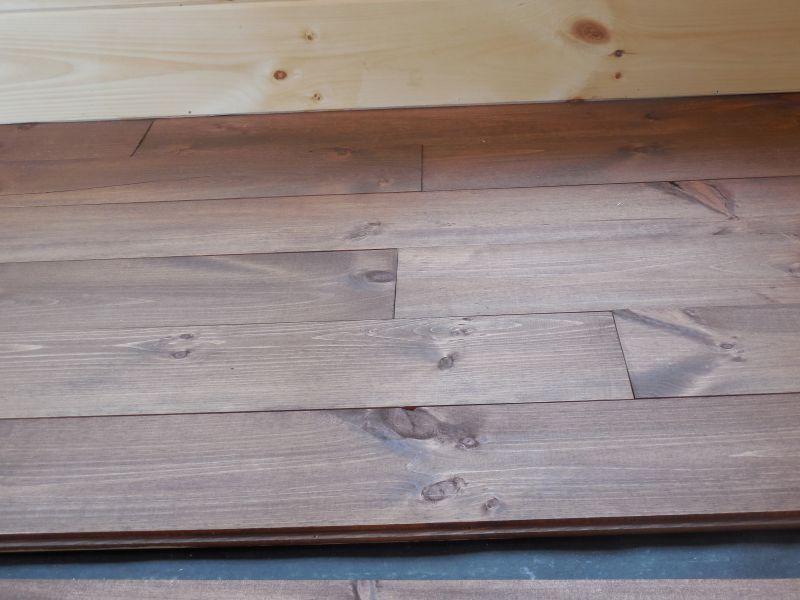

We did our floor with the same siding we did the entire interior with using the flat side with no "v" to do it.
It is 3/4 inch but we put it on top of 3/4 Advantech and a layer of roofing felt.
Flooring

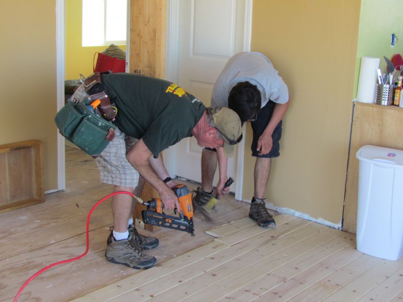

# Posted: 10 Jun 2013 10:00pm
We also used 1x6 T&G pine siding due to it's cost; less than $1 per sq ft... it worked out great.. gotta be careful when picking your boards, check each one by sight to make sure there is as little warping or twisting as possible. I used liquid nails subfloor adhesive and blind nailed the boards with 1 1/4" brads and 2" finish nails. There is no T&G at the ends of the boards so you should and I did face nail it where the boards met and some spots where it needed it due to subfloor. Here is a pic.....
