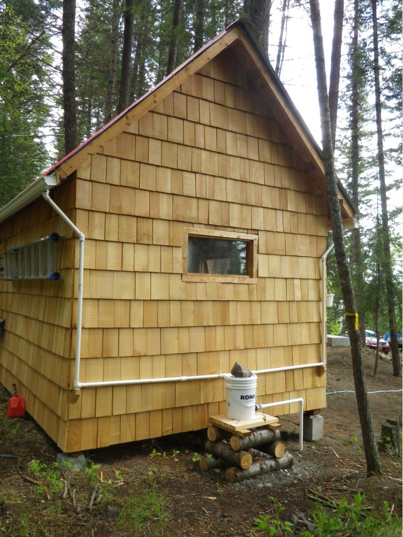

# Posted: 10 Dec 2013 11:04am
  We used a gutter guard that we purchased at lowes.  Came in a box of approx 25' vinyl with meek covering, slid under roofing and clipped to outside of gutter.  About $45 a box.  Our gutter drains down through 1" white potable water vinyl pipe to a homemade filter using 5gal new white vinyl bucket with lid.  Pipe comes in side near top, bucket filled with clean small round rocks and fines to 2/3.  Fine mesh filter (no see um mesh) on top that's easy to lift out for cleaning.  Bought fitting at home hardware that attaches to side of bucket near bottom about 1" off to take the water out.  This whole thing sits on holder about 2' off ground. Fitting adapted to 1" pipe with union to allow removal, then runs underground to my 1500 gal water tank.  I find that it's pretty easy to take gutters down in the late fall and put back up in spring.  Use a connector just below gutter outlet to disconnect pipe.  Had to fabricate connection from gutter to pipe using vinyl gutter outlet and pipe adapter, with some mods and food grade silicone.
Dekagoldwingers
# Posted: 10 Dec 2013 11:08am
  Here's a photo.of the filter bucket and piping.
