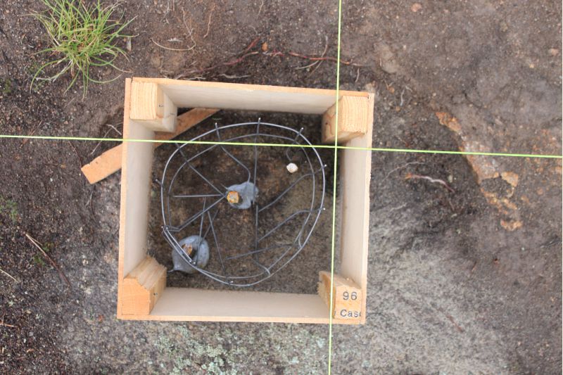

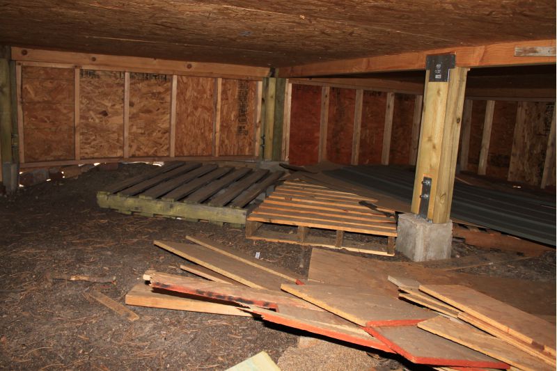

I was lucky and only had to dig deep holes for 2 of my 12 footings. Most I was able to hit bedrock on the surface or at less than 12-18". I built some cheesy forms out of particle board, drilled 1/2" holes and epoxied rebar about 6-8" into the hole. Pic #1. Some were up to 15" long and I then made a heavy wire cage for support. I did add maybe 10% extra portland to the Quickcrete when mixing (advice from on old concrete guy I knew) and so far they have been great. Had 3 winters, high winds, lots of snow at 8000' and very happy with the results. I am with Bldginsp on just pouring a good footing and topping with a post base. Pic #2. I bolted a 4x6 on that and then sistered pressure treated 2x4 under the beams for peace of mind. My crawl space is almost 4' and will give me a place for water tanks and lots of storage.
Hopefully the rock that you hit is bedrock and not just a small boulder right were you don't need it. If is is big enough you might be OK. Good luck !!!
Footing box
Footing box
Footing in crawl space
