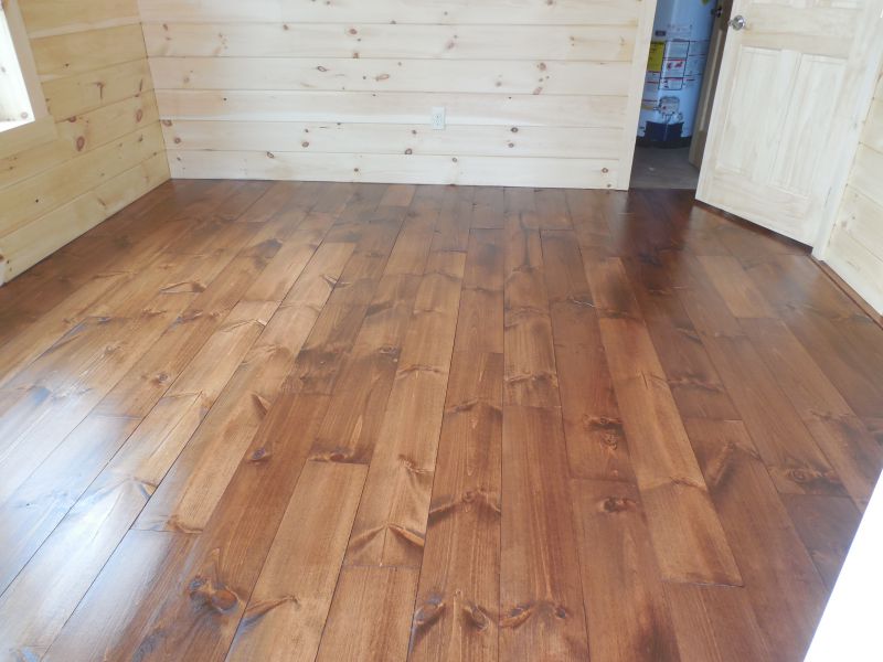

MJW
# Posted: 22 Jul 2013 04:13pm
Advantech here also.
We went over that 3/4 inch subfloor with 3/4 inch pine. Stained and poly.

MJW
# Posted: 23 Jul 2013 11:56am - Edited by: MJW
Quoting: mattd
that looks great but i'm also trying to control cost.
This stuff is 1 x 6 t&g pine siding. It is the same stuff we did the entire exterior walls in. For the floors, we just turned it flat side up.
@ .78 a sq ft, it was pretty cheap.

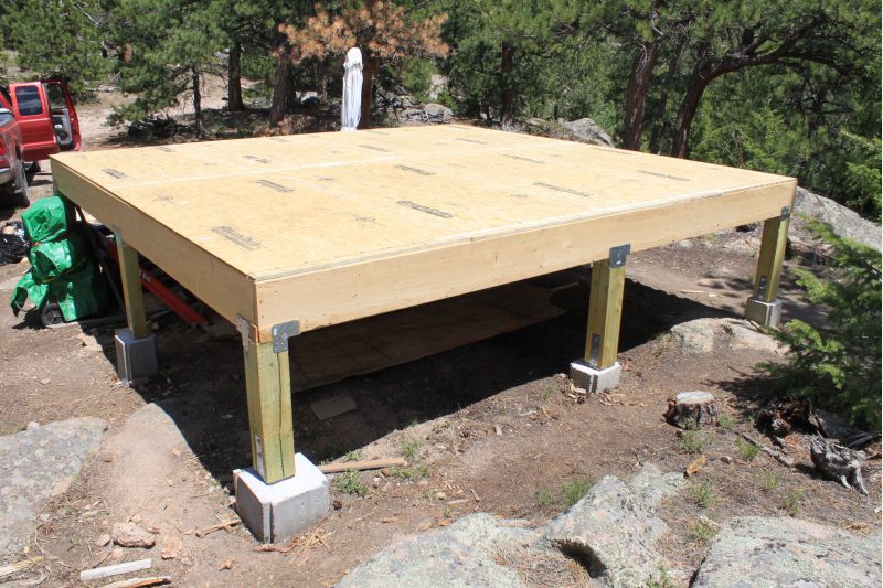

# Posted: 24 Jul 2013 01:52am - Edited by: Storogoth
+1 for the 3/4" Advantech. It had to weather for almost 5 months before I got a roof over it. Held out really well too. Now it's been a couple of years and is solid, no give at all. Well worth the extra cash. Here is mid-June 2011...

mattd
# Posted: 24 Jul 2013 09:12am
Quoting: Storogoth
did you tarp it? or completely exposed?

Storogoth
# Posted: 24 Jul 2013 10:47am
No way to really tarp it and keep all water from not pooling. We had to sweep water and even snow off when we arrived on weekends.

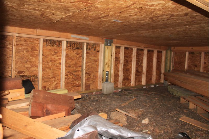

Tobit
# Posted: 24 Jul 2013 05:10pm
Storogoth - what size is that deck? Did you end up adding cross bracing at all? Thanks.

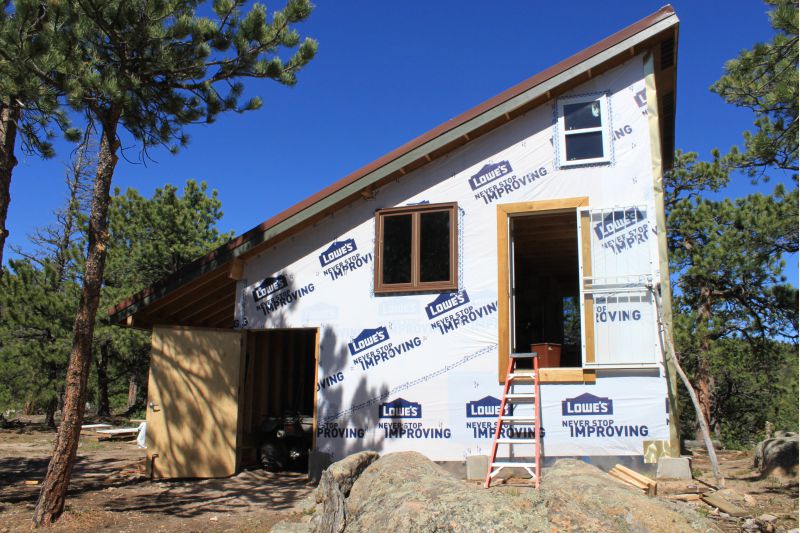

Storogoth
# Posted: 25 Jul 2013 02:13am
Floor of the cabin is 15'x16'. Enclosed space 16'x20'. Crawlspace is about 4' with 2x4 framing and 5/8" sheathing. First pic is exactly a year ago. Second pic about 5 weeks ago. I could always add some diagonal braces but seems unnecessary at this point.
Going up this weekend to get started on the Hardi lap siding.
