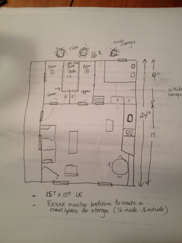

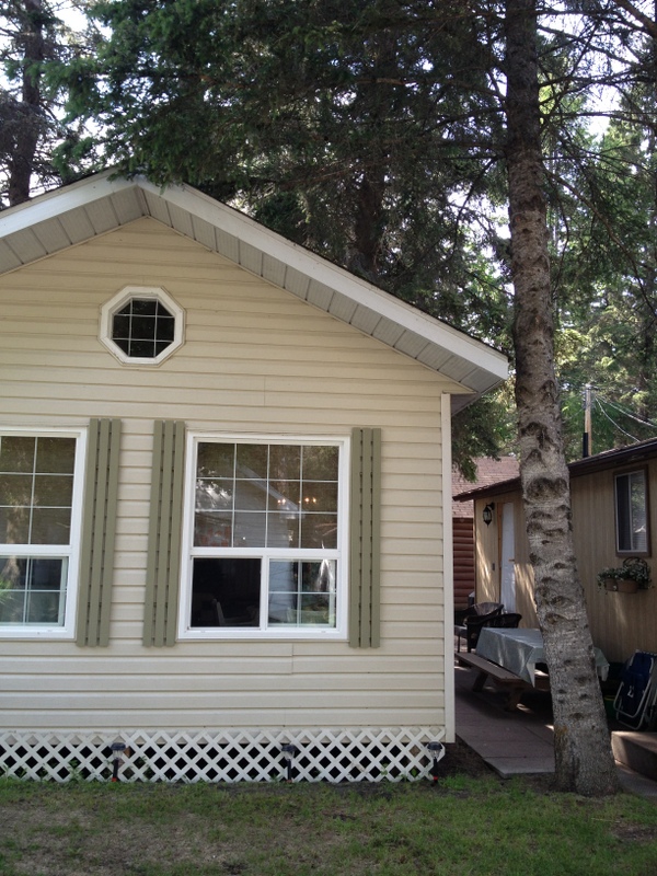

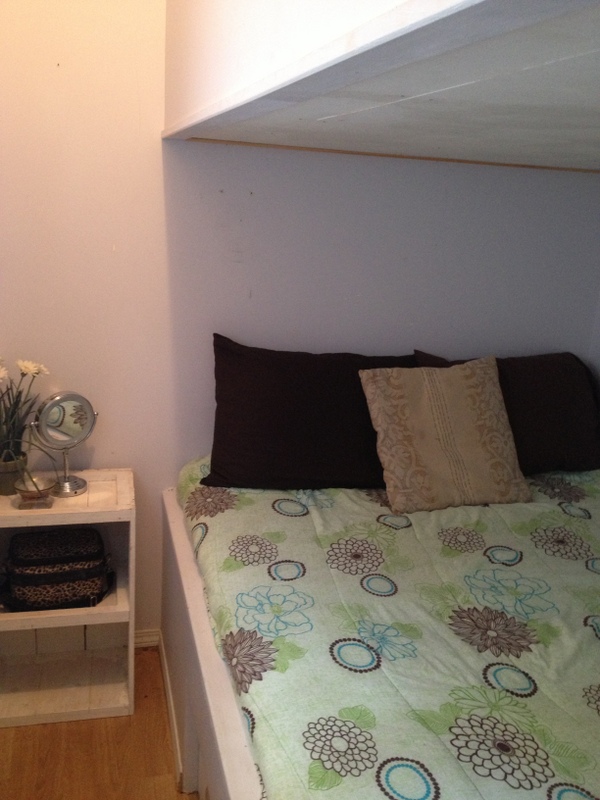

Our 16' X 24' cabin was built when our kids were small and for them to have their own 'space', we basically designed a double bed sized bunk bed that was walled off, so they each had a door to their own room.
The Master bedroom is raised to allow for inside crawl-space storage underneath (accessible from the middle bedroom) and outside storage (a lift-up hatch on the side of the cabin). Being only 384 SF, I tried to utilize every design trick I could to maximize space and it's worked very well for us over the years. Our 2 kid family is all grown up and expanding to 4 adults, a little one and more dogs plus the 2 of us, but they still like to visit and sometimes there are a lot of bodies in there, but we somehow make it work. One is a plumber. Bonus!

We have 3 trees directly behind the cabin at the rear of the lot, which is where we'd have to expand (no more room in the front setback unless we move the cabin). Trees are about $300-$400 a pop to remove, but we'd do this if it meant a washroom building.
I've misplaced the original blueprints, but the roof construction is a scissor truss (vs. a centre beam). I cannot remember the height right now, but somehow between 14-15' comes to mind.

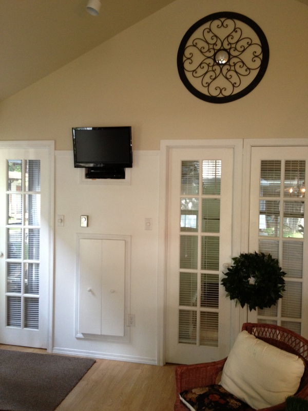

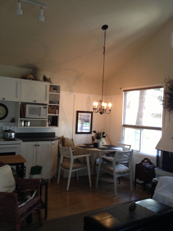

Hand Drawn Rough Sketch
Middle bdrm plus raised master bedroom

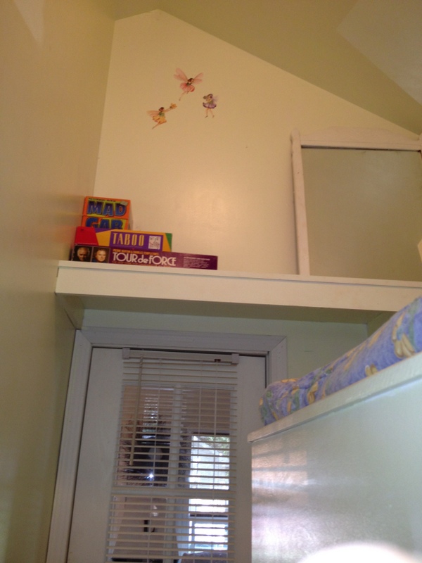

Lower Bunk - Bedroom 1
Looking out from Bedroom 2 (middle)

For me it would be an easy decision.....I would take out the 2 small bunk rooms...there I would make the bath and a hallway that leads to a 8 x16... 2 story addition, built to the 20 ft limit height, I would play with the roof lines on paper , could come up with a great look with the new roof lines at 20 ft peak height on the addition, as the addition roof lines would be offset from the main cabin.... Bottom part of the addition would have the hallway from the cabin lead into a small 8x6 mudroom with patio doors to the outside rear and small deck, the other 8x10 of the 1st floor addition area would be a bedroom ....spiral staircase or pull downstairs in the mudroom to upstairs of the addition....larger bunkroom up there, maybe 8x12 allowing for stairs.
Lakelady
# Posted: 29 Jul 2013 06:23pm
VTweekender, that could be quite a viable option. I like it.
See what I mean? Sometimes we can't see the forest for the trees and/or think of the most complicated plans when it doesn't have to be.
I'd better get out my napkin and pencil for some preliminary sketches. My favourite way.
Your thoughts are much appreciated, indeed!

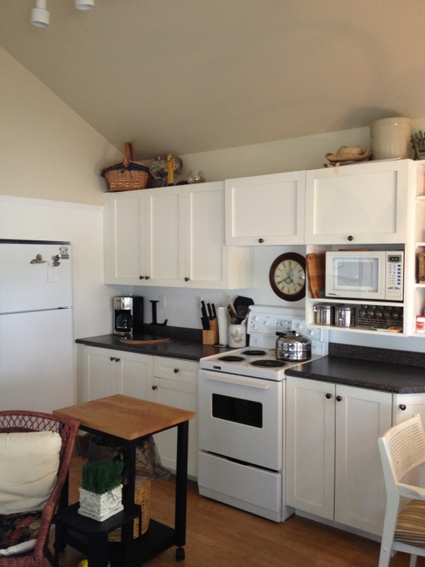

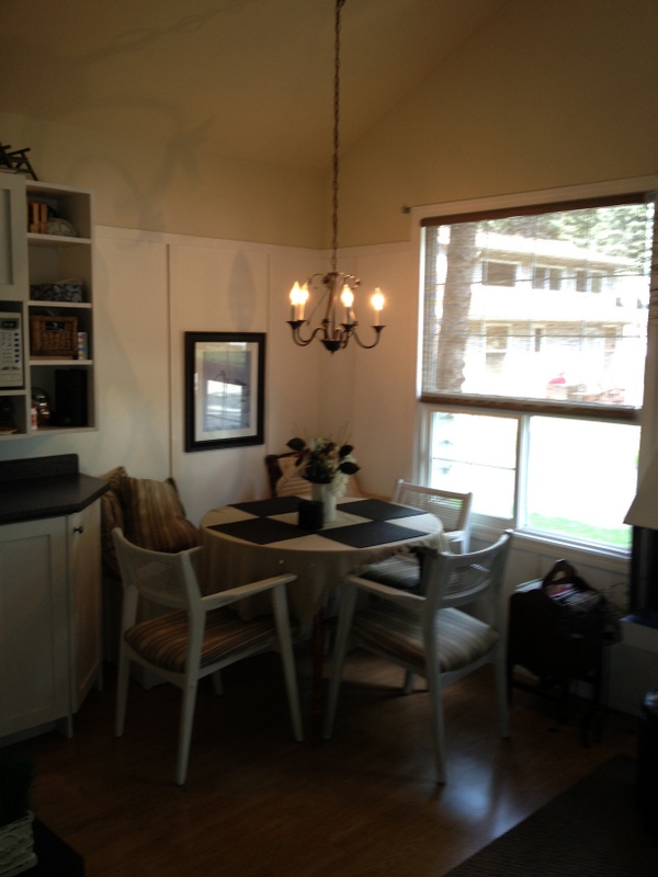

Cabin 1
Cabin 1
Cabin 2
Cabin 2
Cabin 3
Cabin 3
Cabin 4
Cabin 4
