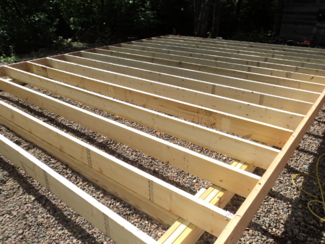

This building is fifteen years old in frost country , Northern , WI, and hasn't moved, according to the owner. I'm sure it does, but as long no one notices, and it does no damage. On 14' again 12'' centers on 2x6's cantilever joist over skids by a foot. 2x8's make a little firmer feel and maybe drop to 16'' centers. Overkill is fine , but a waste. I'm sick of waste. Especially in government.
O

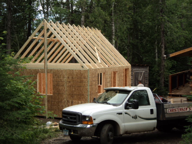

# Posted: 15 Aug 2013 10:01am
I think this one was actually 16' wide ,but you get the idea.

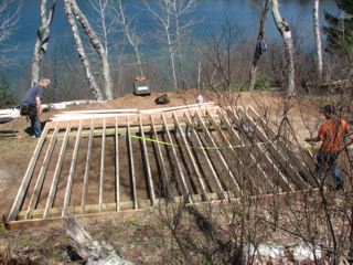

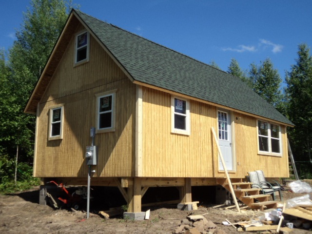

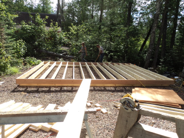

# Posted: 15 Aug 2013 10:06am
More pictures. I'd love to build where there's no frost. It would be such a piece of cake. Remember to keep white wood 6 to 8'' of the ground.
