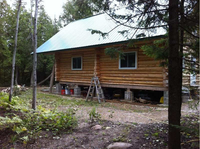

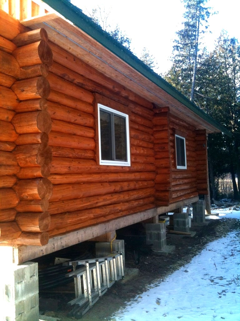

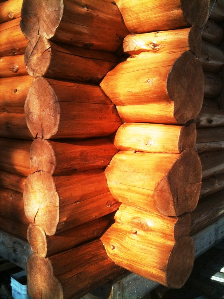

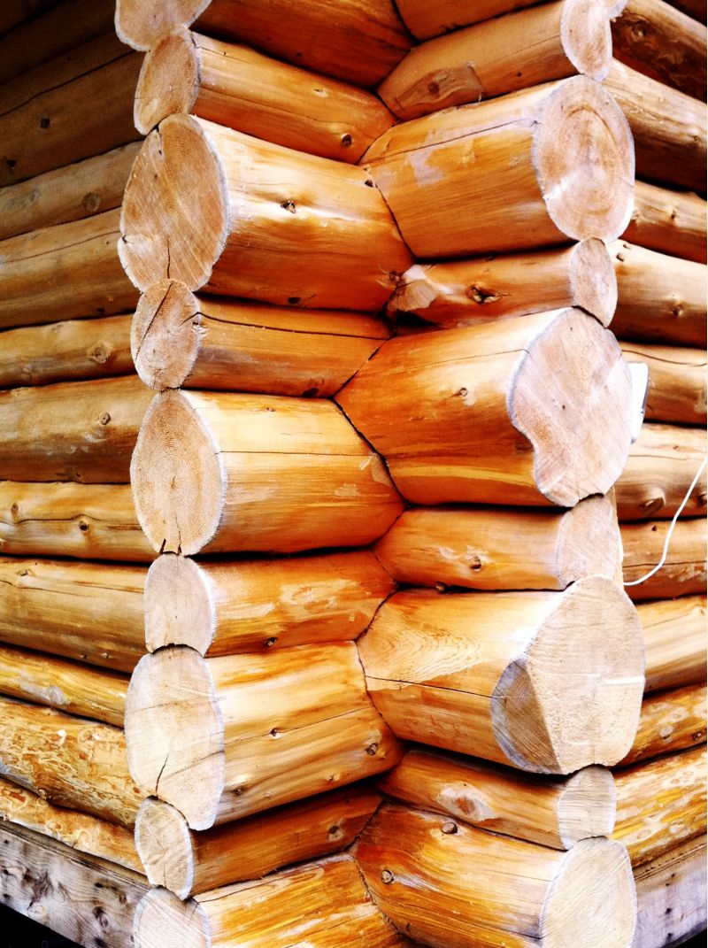

# Posted: 11 Aug 2013 12:14am - Edited by: silverwaterlady
We have a log home in Canada and used Perma-Chink. You know when a log or wood starts to turn that silver gray that some people love? That is the first stage of rot.
I posted photos on here of before and after about a year ago.

# Posted: 12 Aug 2013 02:54pm - Edited by: silverwaterlady
Could not find the link. Here are some before and after photos:
