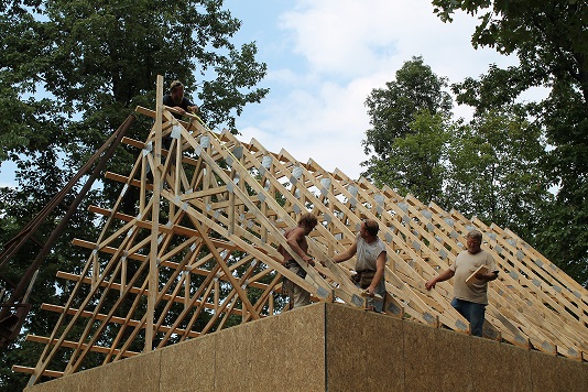

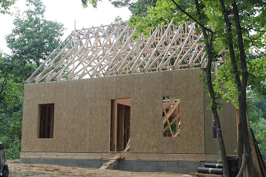

I'll try a pic that shows where we are as of yesterday, 08-17-13. One shows the trusses with purlins 24" on center. The plan is to put the osb on top of the purlins, 30 felt, then the metal. Cabin_081713.jpg

# Posted: 18 Aug 2013 09:35pm
I don't understand why the purlins are there at all. Especially with the OSB on top where it becomes difficult to impossible to nail all the OSB panel edges to gain the strength that gives.
Trusses. No overhanging eves? How much insulation will you be able to get in there near the eves? Venting?

# Posted: 18 Aug 2013 10:22pm
I was a little skeptical about screwing the metal to 7/16 osb. Now the screws will go through the osb and into the 2x4 purlins which are 24" on center. Something that is missing in the pictures would be the lookout rafters which will hold the osb on the outside edge of the roof. 1 ft overhang on each of the 4 sides counting the porch.
(The 2x4 purlins are not on the front yet in the pic.)
The front, which you see in the first pic, will also get an 8 ft wide porch so 2x6's will be used as rafters on the shed porch. This will give the porch a 3/12 pitch and it will get vents at the transition point between the 2 pitches and the porch ceiling will have to have vents too.
Not sure how much insulation I can get in the eaves. Plan is to use the plastic baffles in the eaves to retain an air flow up gap to the vented ridge cap.
I think the only thing different in what we are doing and how most pole barns are done is my trusses are 24" on center and we are adding decking.
Hope all that makes sense.

# Posted: 20 Aug 2013 11:16pm - Edited by: ICC
All I can say is I have 7 buildings of my own scattered about the ranch. Assorted sizes and all with ribbed metal panel roofing screwed into 7/16" OSB, with the OSB nailed to rafters or with the big barn, nailed to trusses. In the past couple years we've recorded a half dozen or so wind events with sustained gusts of 55 to 65 mph and the grand daddy of 89 mph this summer. We've had many trees go over, some living, some dead. Fortunately none fell on anything important. A few still hanging and needing attention.
None of the metal roofing has ever shown wind related problems.
