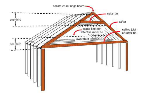

 Quoting: bluewillo No cross beams. It does get rather windy out there, so I am thinking about adding, about 4 feet down from the ridgline, 2x6 crossbeams to sturdy it up
  There are two kinds of 'cross beams' as you call them. One is a 'collar tie'; the other is a 'rafter tie'. They both have a specific task and are not interchangeable. Note; you may well gets lots of differing opinions on this matter; there are many bldgs that do not have either thant are still standing after years. That is not a guarantee that everyone will have the same results.
  With a steep 12/12 pitch you may not have to worry over snow loads, but those high winds can also exert large loads that can try tp spread the wall tops.
  See image below for details
  What is the purpose of each? Collar Tie; keeps the roof from peeling open at the ridge under certain high wind conditions. They work best near the peak but can be anywhere in the top third as illustrated.
  Rafter Ties; keep the wall tops from spreading apart. Ideally on the wall tops and nailed to the rafters. They can be higher in the roof triangle as illustrated. As they are placed higher in the triangle they exert forces on the rafters that may overload standard sized rafters. Rafters often need to be sized upward like a 2x8 instead of a 2x6. There are tables and notes in the IRC.
  The size of the rafter ties can vary; id only doing the job of a tie, 2x4's are okay for this size bldg. If used to secure a ceiling they need to be bigger and if used as a floor for the attic even bigger again. There are tables and online sizing tools. Some are referenced in the forum reference section.

  Not only will the sheathing remove the condensation problem but it will strengthen the roof immeasurably. Then #30 felt (tar paper) or synth membrane. Then put the metal back on. Best to use new screws; easier and quicker and better.  Rafter & Collar Ties illustrated.
