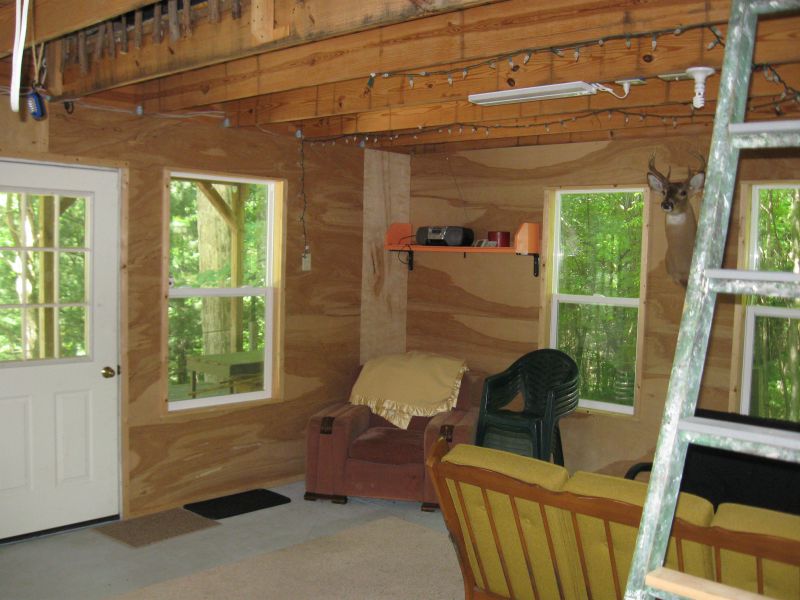

I used 4 by 8 panels of luan - see http://catskillcabin.blogspot.com/2011/07/july-in-medusa.html for details, you will have to scroll down some. I was going to slap molding on to hide the seams, but realized that would only look like I was trying to hide the seams. So I left it, and I like it this way.
Good luck!

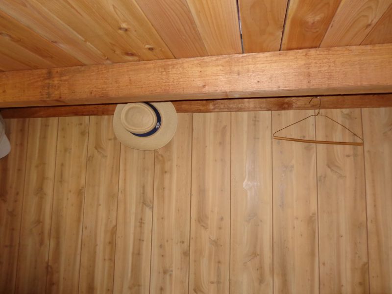

I used what Lowe's calls a "utility panel" - very pretty on one side, light, and cheap. I also did this on the ceiling. At joints that couldn't be butted with factory edges I used firring strips. I like the look.
Cabin Interior
Cabin Interior
tnky03
# Posted: 15 Aug 2013 04:08pm
VC_fan, that looks really nice! We are also using some furring strips for trim. It is a great savings and I like the simple look. I love those exposed ceiling beams.
