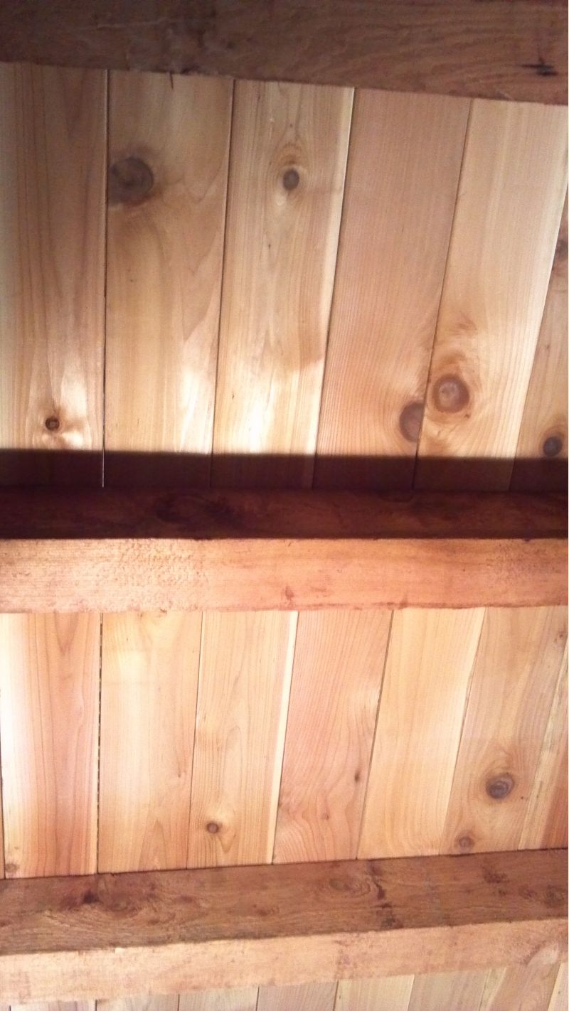

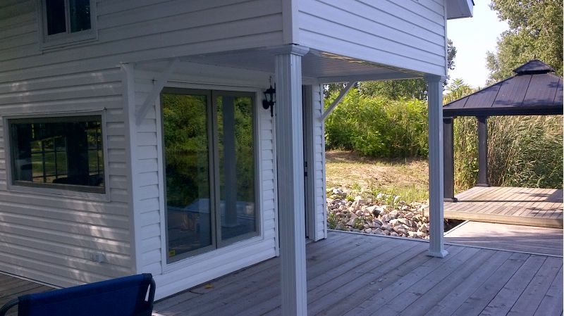

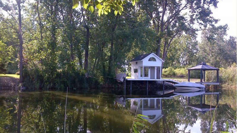

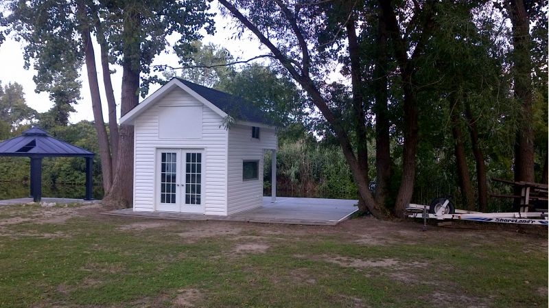

Here is a picture of my two story cabin on my dock. Note the first floor ceiling is 6' 10" with open 2" x 6" second floor framing giving it the feeling of being much higher than it is. The second floor is 6' 0" in clearance, all of this so as to meet codes for my area.
We never have anyone mention the height of the building, having the floor joists open really gives you that feeling that the ceiling is much higher.

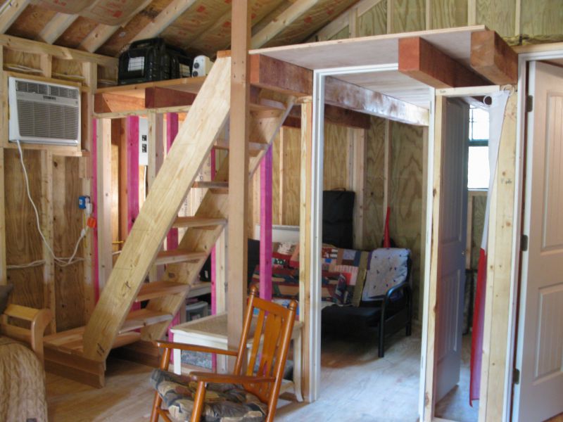

# Posted: 16 Aug 2013 07:07pm
Mine are right at 7ft. With that you can have regular sized doors underneath and have room to finish off the under part.

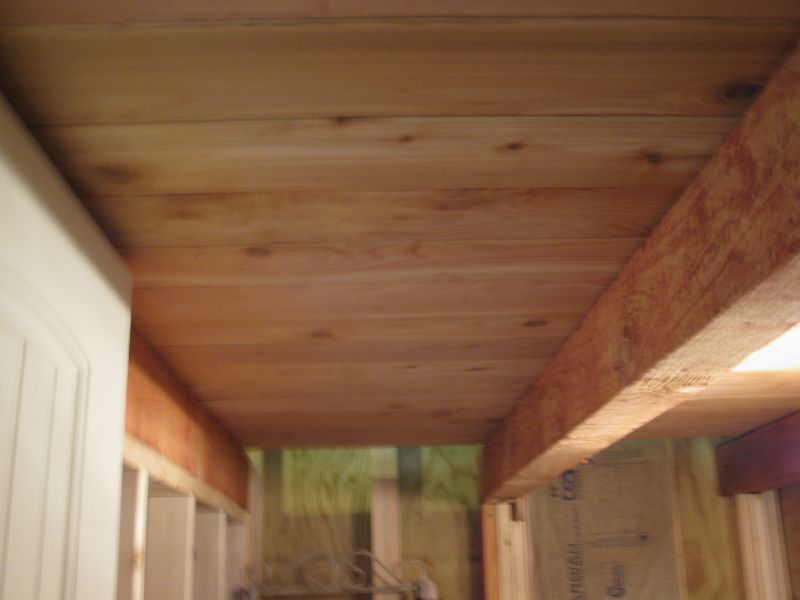

# Posted: 16 Aug 2013 11:22pm
Ours is 6'4" And it works fine. No complaints
