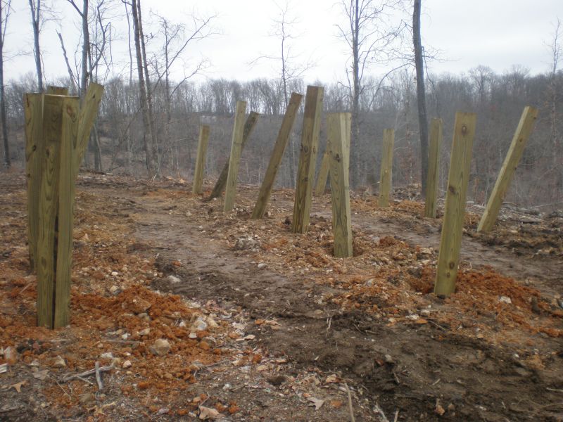

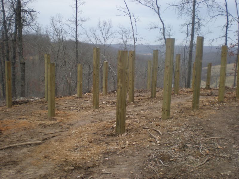

Sturdy for sure. You wouldn't even need the center beam, but you said you wanted to overbuild. I have build several with treated 6x6's instead of concrete. They're rated for 40 year ground contact and can be cut off exactly to a level shot. They also attach better. Just an idea.
Owen

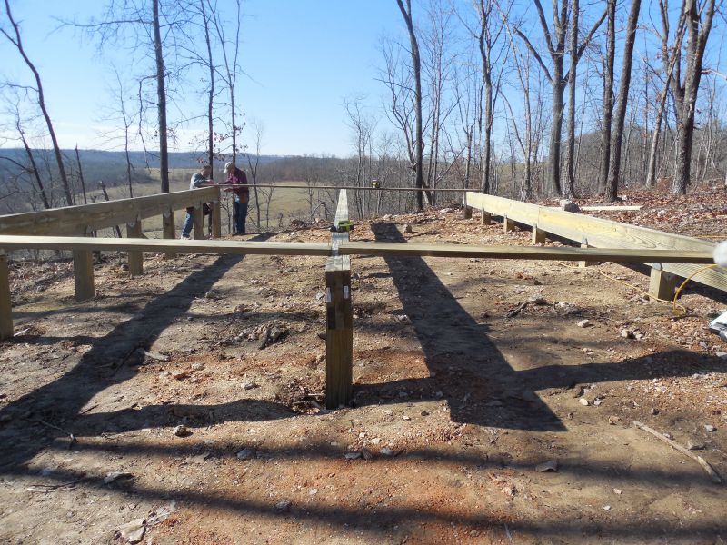

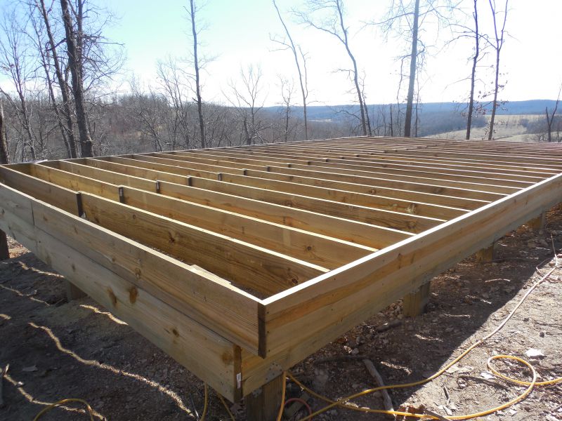

We built our 20 x 32 on 21 foundation grade 6 x 6s. Three rows of 7 with three beams made of PT 2 x 12s three thick.
Sturdy as can be. 40 years works for me.
