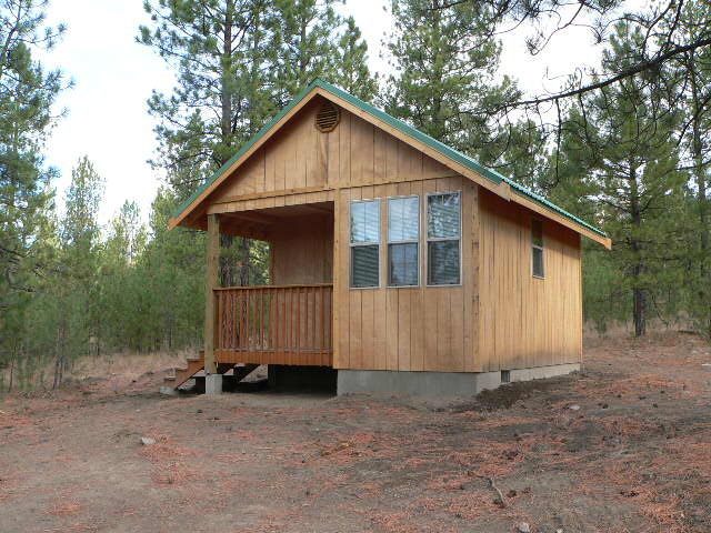

# Posted: 28 Jan 2010 11:38pm

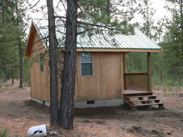

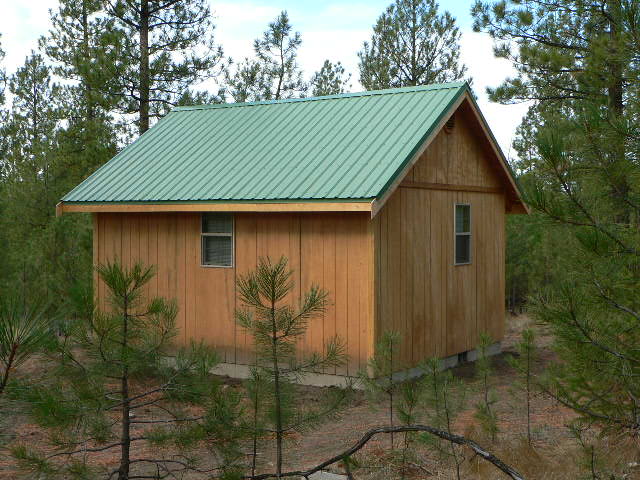

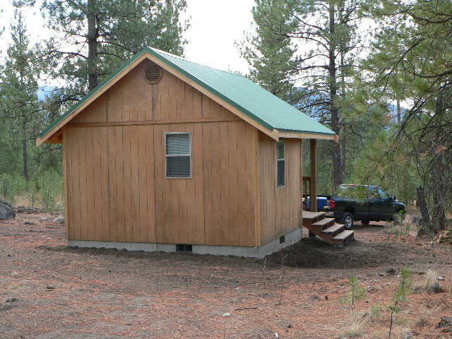

I hired a friend who is a professional builder. Had another cement buddy do the foundation (regular footing/stemwall) and the cabin took us 9 days. I also contracted out hte metal roofing. I had to come back to finish the porch and a few loose ends. All in all, I have about 10 days work in it. Its unfinished on the inside. I start working on that in April this year. Woodstove, insulation, wiring, plumbing...
I pulled the permit myself, went real well.

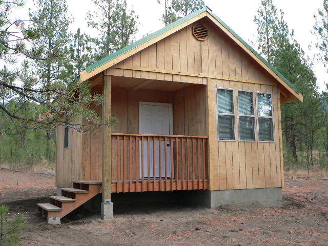

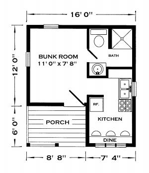

That cabin looks nice. Post some pictures of the floor plan whne you get the chance.
# Posted: 9 Feb 2010 09:37pm
Quoting: anonymously That cabin looks nice. Post some pictures of the floor plan whne you get the chance.
Here ya go. I have only the one wall in place now, going front to back. I will add the wall between the kitchen/bath in April, then I will be over there for a week and doing plumbing, electrical, insulation and possibly a woodstove. Time will determine how much I get done, I have a recruit. Then my last phase is interior walls. Not sure what do do there yet. I dont want too spendy. I have a range and sink from a camp trailer, I will buy a propane fridge online. I have the windows all trimmed out with mini blinds. I will take and post pictures when I'm done in April.

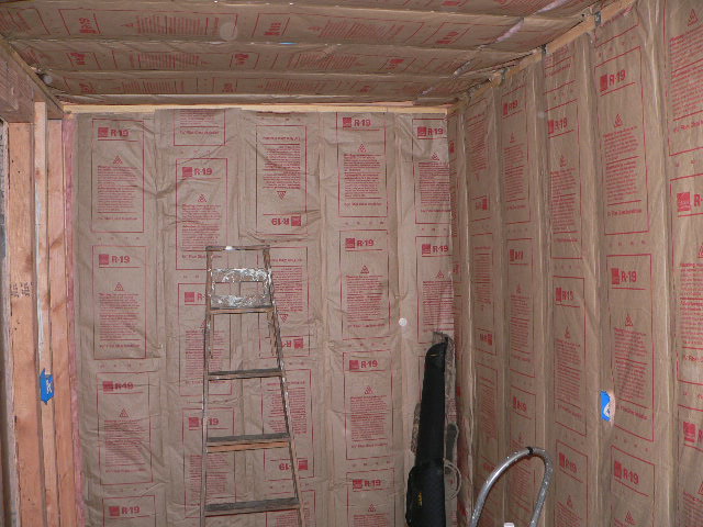

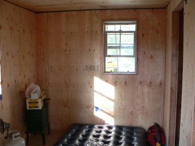

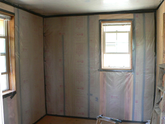

I have a few, I just went and wired, insulated and sheated it last April of this year. I have a stone mason showing up soon for a bunch of rock work behind the stove (corner, out 4 feet on each side, all the way to the ceiling plus a stone hearth) and headed back over in Sept to paint it. Going to be Forest Service Brown in color. I have yet to set up the kitchenette and main room yet. Everytime I go over there, tis to do work. But soon, it will be to rest. Getting close,t hen I will add some furnishings and then can just go ro relax, not even bring tools. Here is a few inside pixs now. I have added the wall between the kitchenette and bathroom now. I made it flat, the plan shows a crook in it. I'm trying to keep it simple as I can.
# Posted: 5 Aug 2010 09:07am

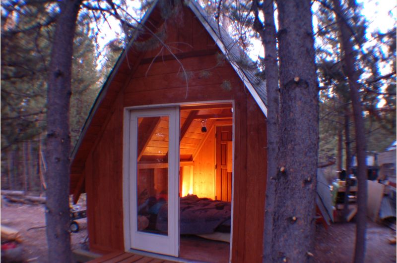

Looks like you're doin' it right. Thanx for the update. We built our 10 x 12 cabin last summer. Next the 14 x 16, but not such a severe pitch.

Gary, looks so cozy with the amber glow of the light. Looks like it came right out of a Thomas Kinkade painting.

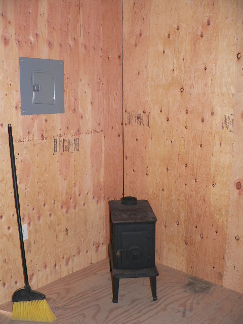

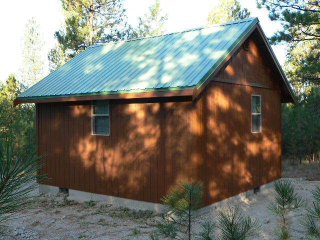

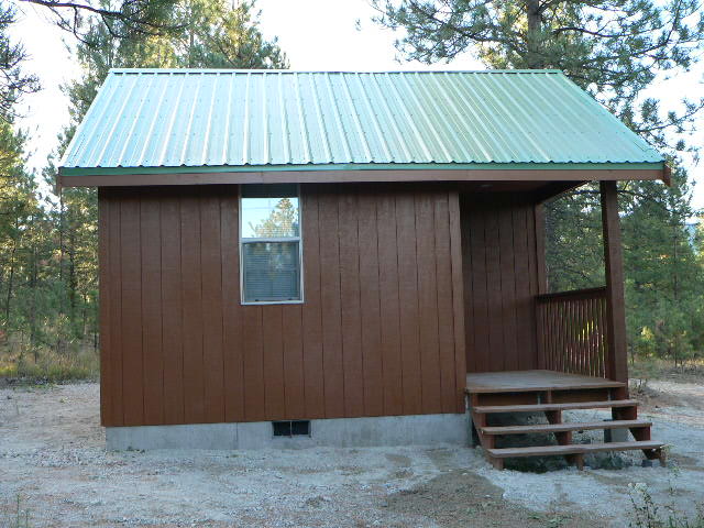

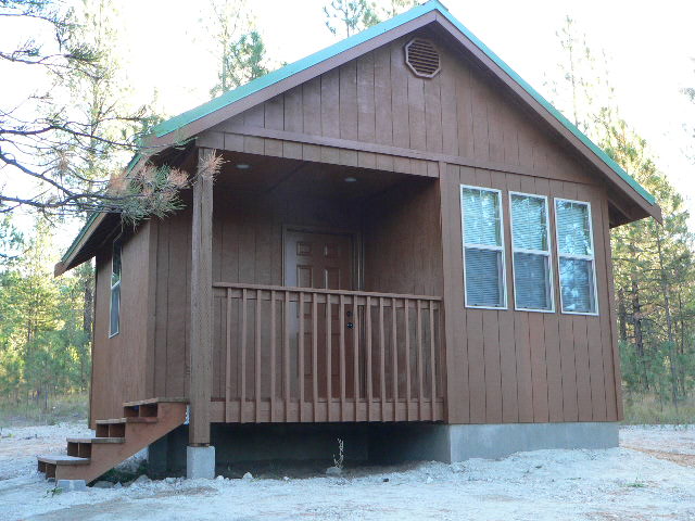

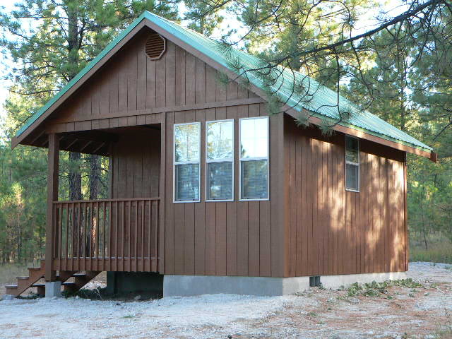

Gary, usually a meadow is a result of water leeching out of the hillside or up through the ground and running down the hillside to create these meadows. Like an artesian well etc. OK, I have my cabin pixs posted in another thread, then found this, so I figured I'd update it with my finished exterior photos (painted in Forest Service Brown) and some interior photos. Inside is all sheated in 3/8" plywood. I use only plywood in my cabin, no OSB. Cost was only about $3 more per sheet. I'm headed back in 2 weeks from now with my stone mason for the rock work behind the woodstove. I will snap a few photos. I will post a photo of the stove in its final resting spot minus stone work and chimney. front
|  front

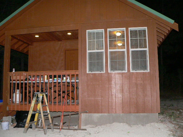

A few inside and my privvy. Stove in its corner, less stone work and flue
|  Glow from kitchen lights and porch lamps

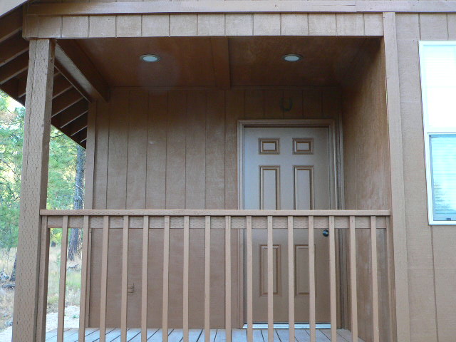

|  Finshed porch. Wrapped the 4 2X6 header

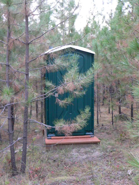

|  Privvy. OKk I cheated, bought a brand new one from satelliteindustries.com ie the Tufway 150!

Man, your place is classic. Can't wait to see how the stone work looks.

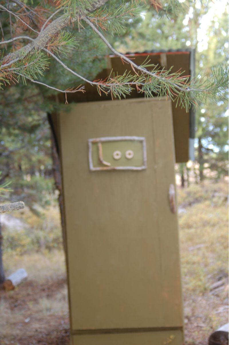

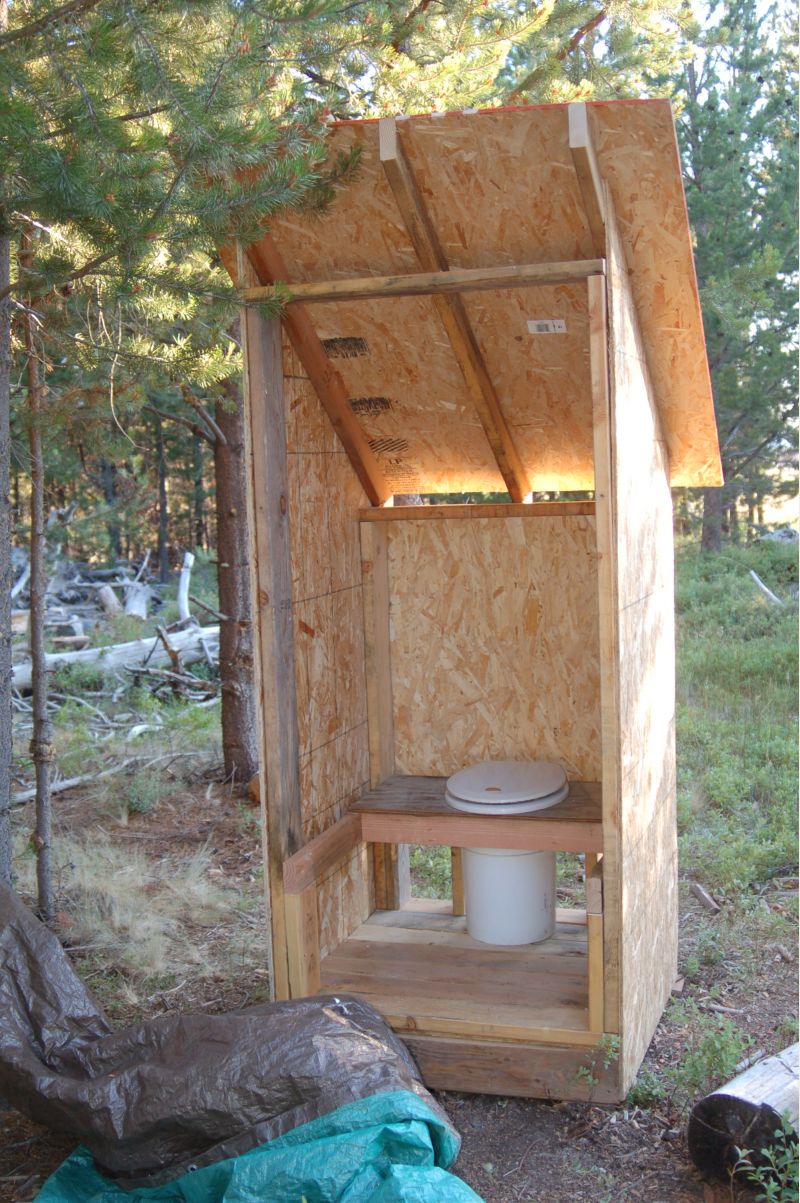

The wife and I talked about getting a construction privy like yours, but I had enough scraps to put one together. Using a removeable 5 gal bucket, and we're in discussion of what to use to speed up the breakdown.....and kill the aroma. Have a plywood insert from the back end that keeps flies out and smell contained.

Truth is Gary, time was a factor for me, the new plastic privvy just made more sense. Cost was a bit, ie $695. But hey, it has a nice vent stack, screened, secure door, dispenser, urinal, coat hook and its fly tight. I have an extra 8X8 treated timber from my cabin. I ended up with an extra because I moved the stairs to the left instead of to the front. It was about a 14 footer. I cut it right in half, lag bolted the privvy to it (it had provisions for bolting it down) then took some extra decking and made a porch on it, blocked it in on the frotn and back. The footing makes it secure, wont blow over in the wind etc. We dug it in a bit and backfilled it to keep varmints out. For me to build one would of taken a day or two easy, plus all the hardware, accessories. This just made more sense at the time. Gary, I picked it up out of Portland Oregon (warehouse) and my daughter lives in Oregon, so I bought it for her (wink wink, sales tax...)

Quoting: Gary O Looks like you're doin' it right. Thanx for the update. We built our 10 x 12 cabin last summer. Next the 14 x 16, but not such a severe pitch. cozy_cabin.jpg
Wow!!! Gary that is one sweet cabin. I love the interior paneling. Tongue and groovy?
# Posted: 23 Nov 2010 10:17am
Quoting: SquidLips Tongue and groovy? Thanks SL No, shopped/priced T&G, and car decking. Couldn't readily find anything better than #3 grade. Used 2x6 KD spf. However, I had to have it delivered, since it was 14' and too much for my tiny trailer. Called it in, explaining my need for select boards. Big mistake. Seems they delivered a pile of culls, as there was so much wane and warpage I had to sheeth it. Yeah, big box store (your unhealing, festering wound). Pro Lumber. Next time I'll hand select.

Quoting: Gary O Using a removeable 5 gal bucket, and we're in discussion of what to use to speed up the breakdown.....and kill the aroma.
Sawdust
# Posted: 23 Nov 2010 11:23am
Is sawdust faster than, or as good as, lime?
Rob_O
# Posted: 23 Nov 2010 12:13pm
Just google "Humanure" and you will find all the info you need to know
