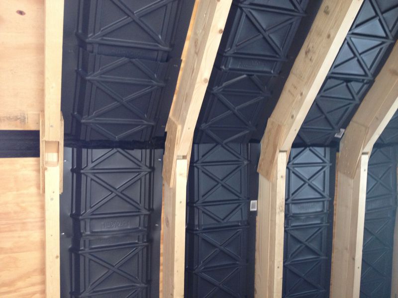

PA_Bound
# Posted: 17 Sep 2013 09:21am - Edited by: PA_Bound
MI Drew... At the bend in the roof I tried it both ways. My first thought was to cut the angled sides of the panel (which give it rigidity) and then bend them in the middle, but I found the panels awkward to work with when I did that. After two or three that way, I switched to simply cutting them completely in half and then butting the two ends together. That seemed easier to work with, and I really couldn't see any reason not to continue that way so that's how I finished them.
At the ridge, I again mostly butted them together but I was not too concerned about how tight the fit was. I figure the air will travel the path of least resistance and once I get the final paneling up that path will be through the ridge vent to the outside. A couple places I left a few inch gap, as it is there I plan to install vents in the interior ceiling to allow the cabin to "breath" when I'm not there and it's buttoned-up. We had problems with trapped humidity in my hunting cabin because of this, and we found that even a little ventilation greatly reduced the problem.
Below is a picture of my ridge. It's not the greatest job, but it works (and once it's covered with insulation who is going to see it anyways?):.
Looking up at ridge- before insulation
