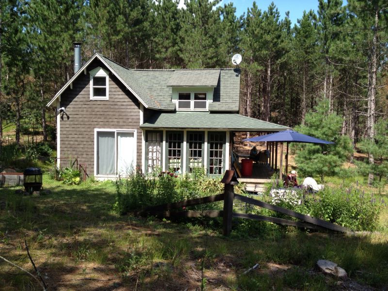

Sustainusfarm
# Posted: 11 Sep 2013 11:38pm
Here is mine...it was east!
