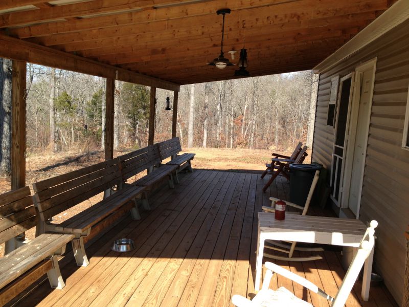

borisvonf
# Posted: 13 Sep 2013 10:13pm
Reply Quote

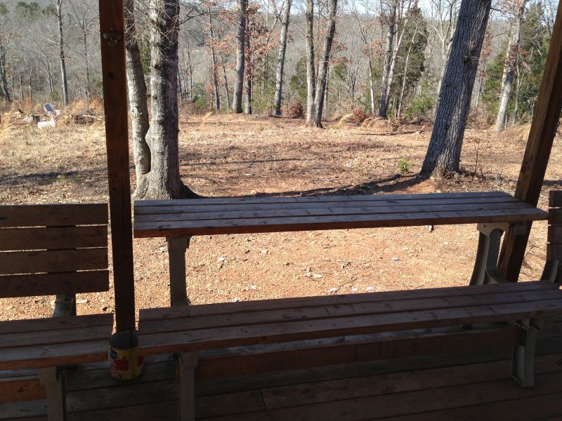

I have a covered porch and used the flip flop bench kit from northern tool as my railing. These flip from and seat with back rest to 1/2 of a picnic table. I got seating, table space and a railing in one package.
borisvonf
# Posted: 13 Sep 2013 10:19pm
Reply Quote
Here's a pic all in bench mode
borisvonf
# Posted: 13 Sep 2013 10:30pm
Reply Quote
Table top

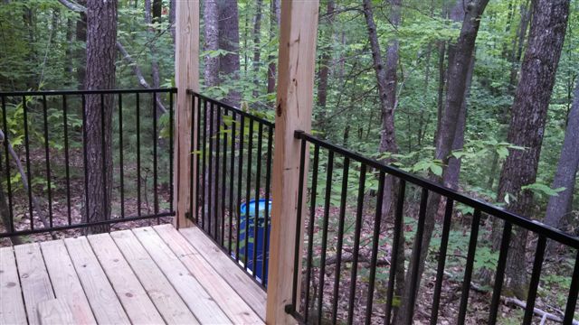

ShabinNo5
# Posted: 13 Sep 2013 11:14pm
Reply Quote
Not quite done.

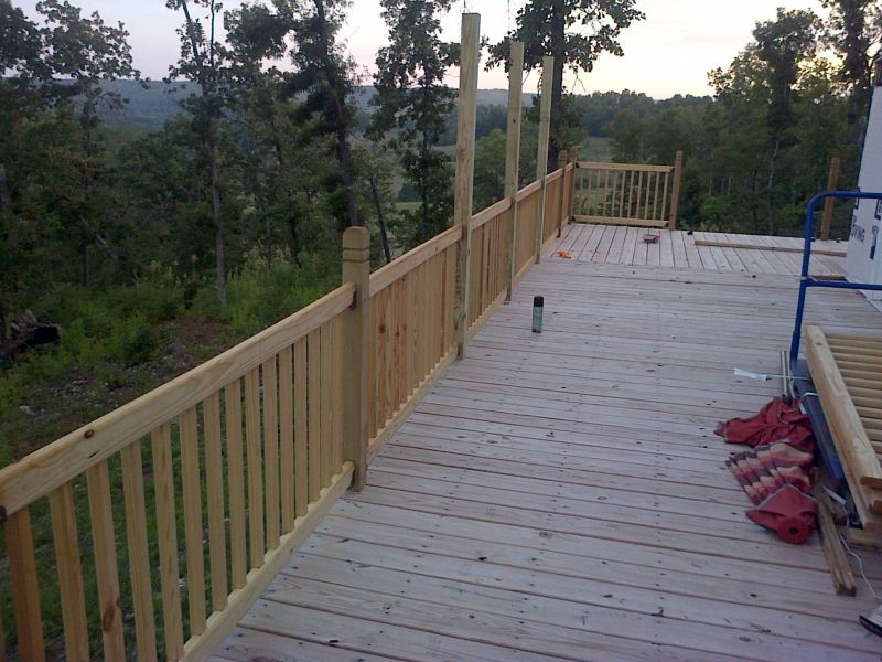

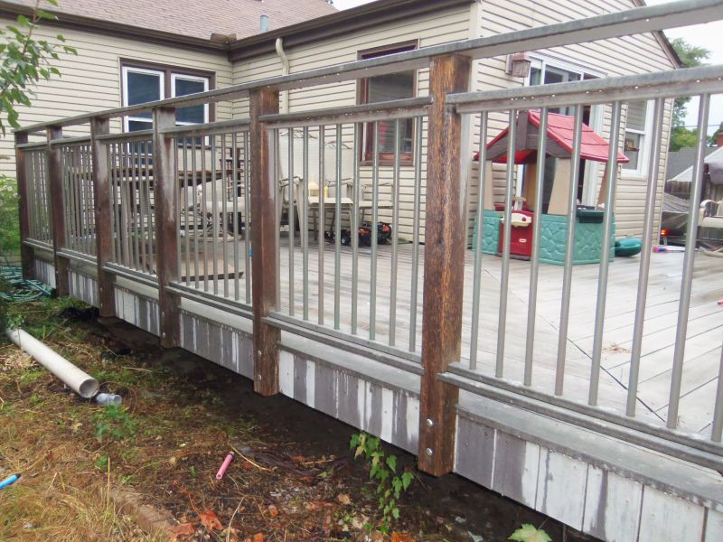

Here's the one I did for our loft its the same as the ones I have done on a few decks. 4x4 post, 2x2 spindles, 1x3 trim, and 2x6 top. Never been a fan if posts that extend past the hand rail, it makes for a week railing if pushed on. I run my 2x6 tops as long as I can and splice on top of a post. Splices are cut at 45deg. Makes for a tight fit.

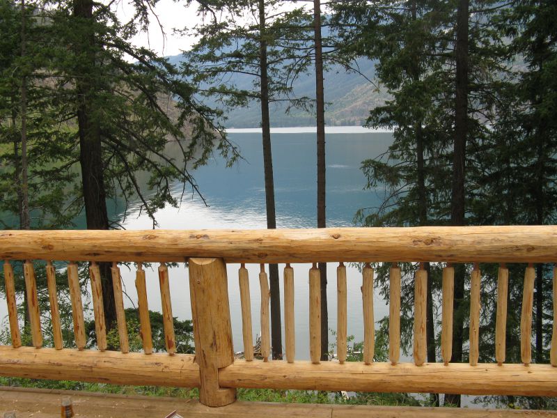

Reply Quote

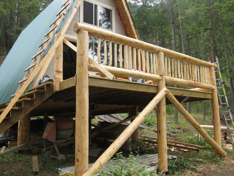

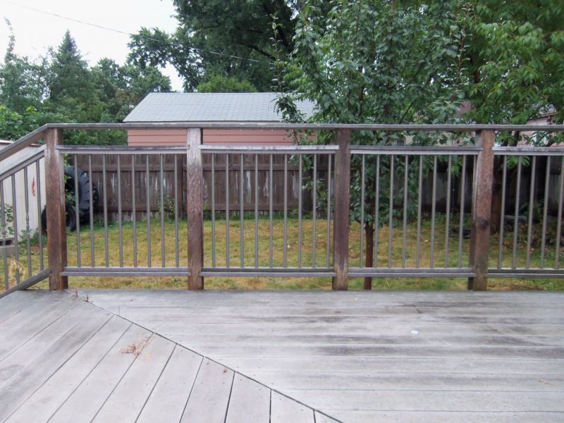

Heres ones I did on our deck posts are cedar and the balusters are aluminum and the rest of components are made from composite deck boards machined down to the sizes I needed

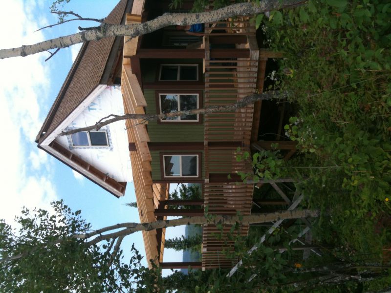

I got a buddy of mine to do my railing and it turned out great. It does take some skill however and was certainly beyond me. I acted as the gofer for this project... IMG_0887.jpg

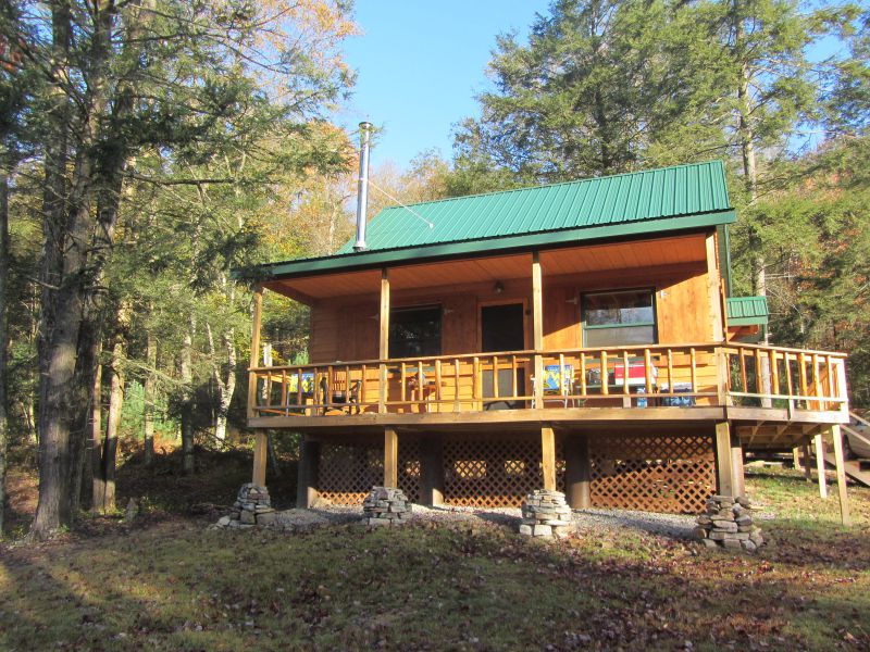

CaveShacker
# Posted: 20 Sep 2013 01:58pm
Reply Quote
Missouriboy, the railings everyone shows in answer to your question are really great, but I know the time and sometimes the expense is up there compared with wire fence. I was thinking of wire fence for a picnic deck out in the woods, but found a yellow plastic mesh fencing (and a lot cheaper than wire fence) at Home Depot that I was able to paint green for a decent look. It's nothing as nice as the others shown here, but half a roll went in for about $25.

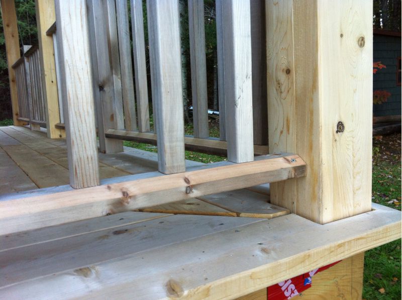

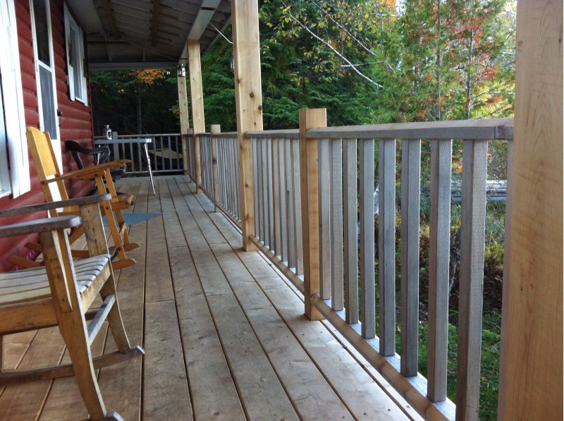

leebree
# Posted: 17 Oct 2013 02:58pm
Reply Quote

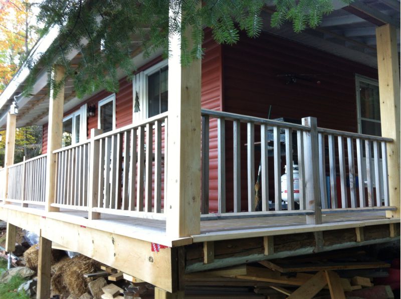

Another example for you. Cedar 2x2 balusters vertically screwed into 2x4s.
The 2x4s were bevelled with a circular saw (no table saw available!). I intend to top the railings with a 2x6 top rail, which will strengthen the whole assembly and raise it up to regulation height (36").

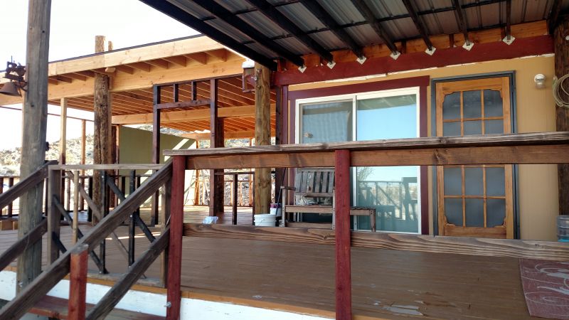

FishPCreek
# Posted: 23 Oct 2013 10:01pm
Reply Quote
Been along while since I have been on or posted. Here is what we did. Got the pre-finished cedar spindles from an Amish contractor who had made an interior handrail that the owner did not like - got them at a buck a piece. Rails/support are pressure treated so a mix of modern and more rustic.

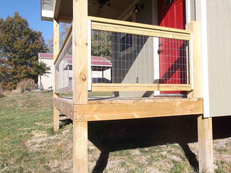

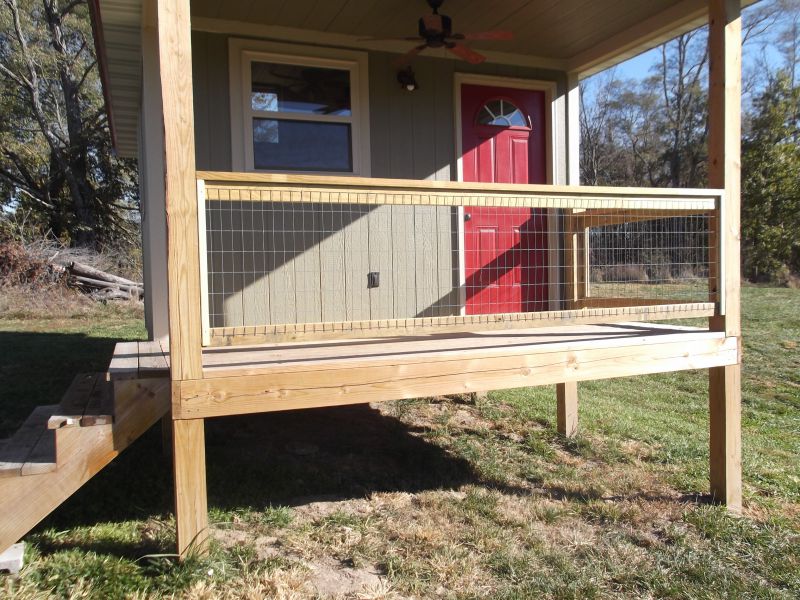

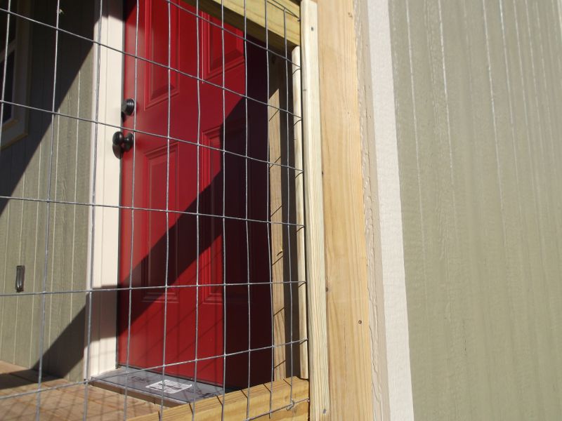

missouriboy
# Posted: 27 Oct 2013 06:14pm
Reply Quote
Lots of great ideas everyone. They all look great. So I finally finished my deck railing with the wire so the view is a little more open. My wife still complains that the top blocks the view but at least it is safe for little ones now. I sandwiched the ends between two 1 x 2's so no sharp edges are exposed and prying little fingers can't get to them. So enjoy the pictures. Just my take on a porch railing.
# Posted: 27 Oct 2013 06:46pm
Reply Quote
Just a reminder that if a baby can get his/her head through, they can get their body through. Codes call for no more than 4 or 4-3/4 inch opening along the guard rail

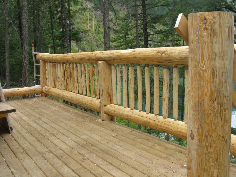

# Posted: 12 Apr 2018 11:35am - Edited by: paulz
Reply Quote

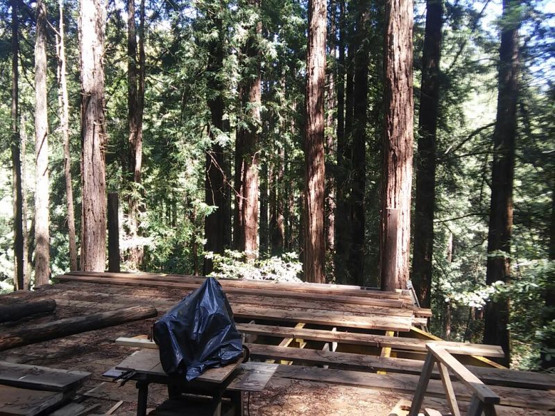

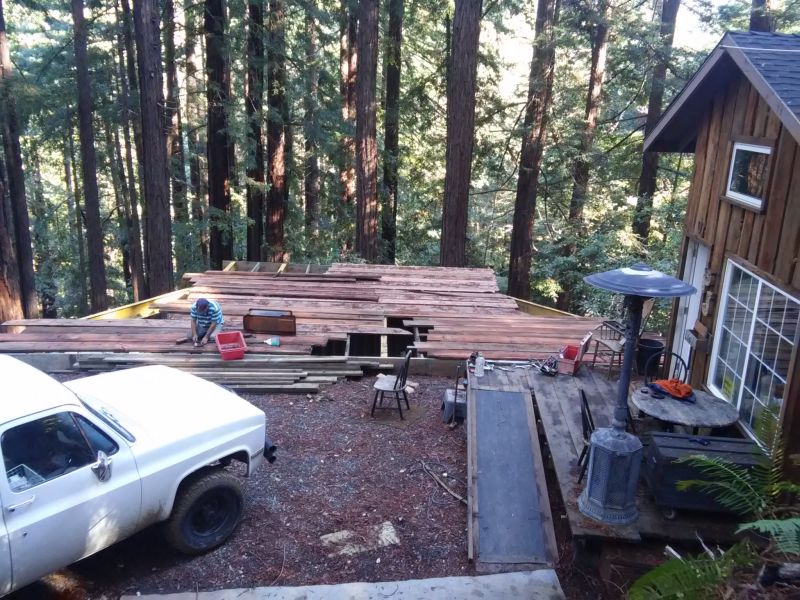

Bump. Some of this stuff looks so great I'm almost afraid to post. But I need to figure out what I'm going to do for my deck railing, thinking I ought to figure it out now before I screw any deck boards down.
As you can see I'm deep in the redwoods, got tons of it but kind of a pain to mill into smaller boards. I thought about using some smallish 6-8" diameter trunks for the posts and leaving the bark on. Or maybe cut some of the long crescent shaped leftovers from squaring my deck board logs into 4x4s with one edge still bark. Maybe some small branches for ballisters? Or just go buy some already finished redwood 2x and 4x4s and do it the easy way? Heck I don't know, any ideas?
# Posted: 12 Apr 2018 07:24pm
Reply Quote
You should check local building codes. If your deck is above a certain height off the ground (typically 2') your railing needs to be 42" high. Also, railings won't usually be approved if a child can climb up horizontal rails.
As to pickets, the spacing can't usually be more than 4 inches apart (to prevent a child's head from getting caught) but cable railings are an unknown. If the cables can deflect (for example, if a child manages to shove his head between them) they could get trapped between the wires so even if your initial cable spacing was 4 inches it could still be a danger.
# Posted: 13 Apr 2018 10:09am
Reply Quote
Thanks Rockies. I've also read that posts must be 6' oc or less but I see many that look like more.

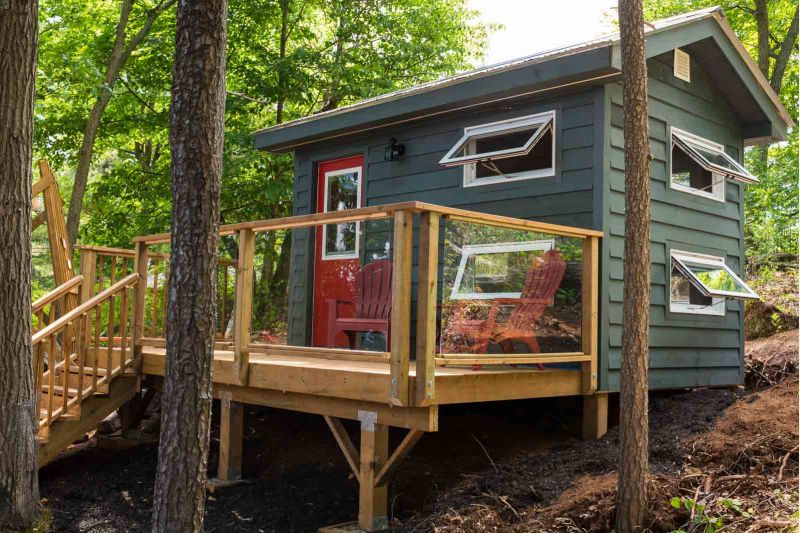

# Posted: 13 Apr 2018 10:38am
Reply Quote
For my bunkie I bought glass from Lowes. It was, IIRC, 60" x 36". I used a 2x6 for the top rail at a height of 42". There's a 2x4 on the bottow, 3" above the deck. I ripped a 5/4" x 6" deck board to restrain the glass.

Looks good. No glass for me, no view, only more (*&^ trees. Today I hauled some old logs up there and propped a couple up at the post corners for a look. Can't hardly see them, just look like more tree trunks. Maybe that's good, I dunno. Price is right.

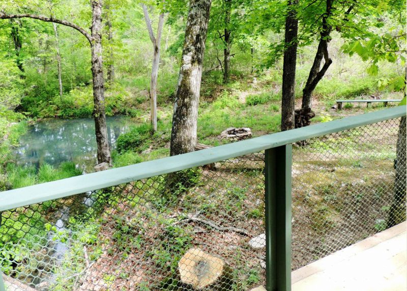

Reply Quote
I used the landscape 'poles' from Home Depot/Lowes, pressure treated, 3-1/2". Used stained Doug Fir for the horizontal pieces. Got some 2 x 2 inch poultry wire in black and stapled it to the wood... Here's a pic before I put the wire mesh on
