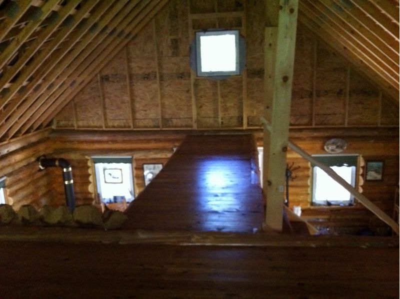

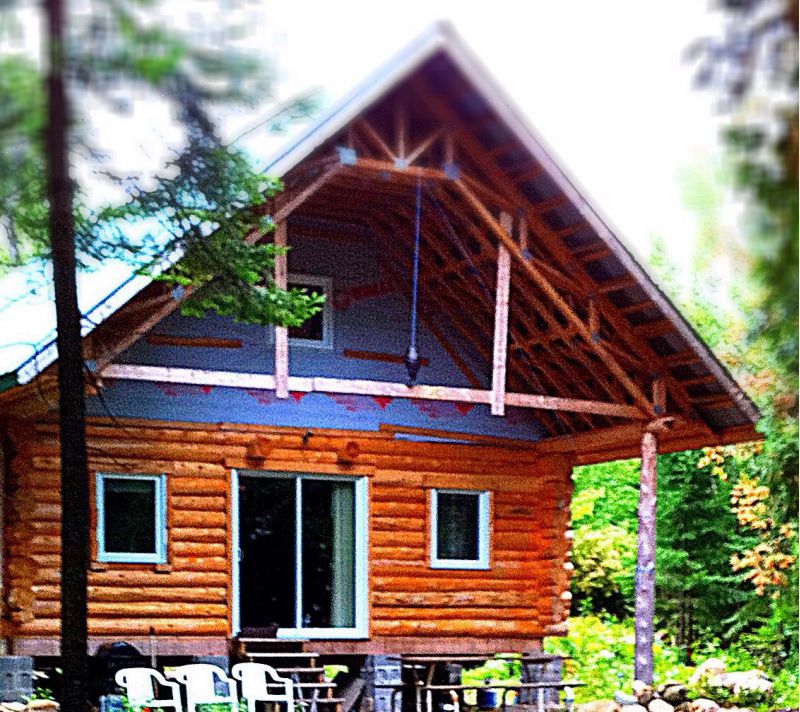

# Posted: 28 Sep 2013 10:06pm - Edited by: silverwaterlady
We built our cabin so that we could add onto the front. This is why we have a big overhang. We plan on adding a four season room on the bottom of the cabin. The base of the room will be natural stone from our property.
The top part will be a small additional loft accessed via the catwalk.
