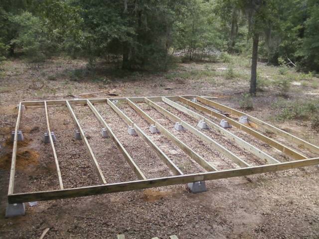

I have been working on a 20 x 20 cabin for a few months, getting a little more material every month around a budget, things seem to be going well and the guides I've found on this site have been very helpful. I'm not very experienced with building an entire building and am still having a bunch of fun. I have run into a small (unless I'm underestimating) issue with my foundation/floor frame.
I have been going along with steps in the proper manner, I have set out the concrete pillars and have 2 x 8's as the frame of the foundation. I have done a lot of adjusting to get the entire frame to be level. It has been sitting level for about a month and has warped a little due to the weather. I haven't really seen an issue until last night while I was installing the plywood onto the frame. it turns out that my angles aren't perfect 90 degree. I was able to adjust a little to get the plywood on 2 of the corners but I am worried about the concrete pillars moving or not lining up correctly the further along I go installing the plywood.
I would really hate to have to move everything and re-leveling, and it's not going to be cement underneath and I already have the vapor barrier in place to protect the underside of the plywood. I am doing everything I can to move the frame as necessary and understand that the foundation is the most important part. However, If my angles are slightly off, will that effect the structural integrity of the rest of the project?
I would guess that my left inside angle is around 100 degrees and my right inside angle is around 80 degrees. I could really use some more experienced feedback before I find myself having to reverse even more work before the building will be finished. I plan on continuing the plywood this Saturday, weather permitting, and hope to hear back from fellow builders by then, if possible.
Thanks for any feedback in advance and if there is any other info that I need to include, please don't hesitate to ask.

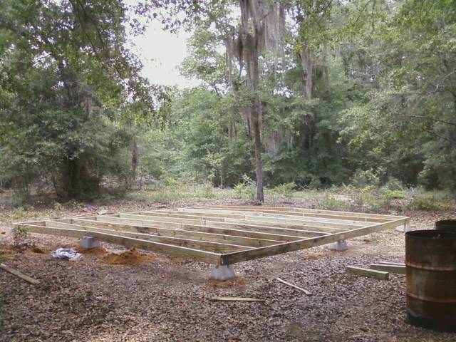

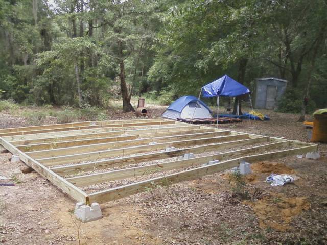

Just as an afterthought, here are some pics to help show the progress, The only new status is the vapor barrier and the front side of the cabin has plywood down

A good way to check square is measure diagonally across the floor the measurement should be the same for both corners there is also the 3,4,5 meathod where you measure from 1 corner our 3' then measure out from the same corner the other direction 4' connecting the the two points should be 5' double the numbers for a bigger square. It looks like in the picture you are using 2x8x10' butted in the center? I mean this in the most helpful way but building this way it will make it very difficult if not impossible to get it square and level and the floor will be wonky.There are some better methods that will give you a better stronger floor. You will need some additional lumber of course. And if you are not flat and square to begin with (Or at least close) It will fight you the entire way to the last piece of steel roofing or asphalt shingle.
# Posted: 3 Oct 2013 08:33pm - Edited by: rockies
It looks like your concrete blocks are resting on the ground or on some wider concrete pads? I think you are going to have major problems with this floor system down the road. For one, getting all those blocks centered and level down the middle of the cabin and keeping them that way is going to be tough, especially if it is already out of allignment. The middle picture seems to show a hump in one of the edge boards already, which will just translate all the way up the building and affect the proper installation and use of doors and windows, plus the roof rafters. I would replace all those blocks with a center beam of double or triple 2x8's glued and screwed together and have blocks under the ends and in the middle of the beam and then attach your joists into the sides of it and add joist hangers. Also, I think the spacing on your joists is a bit wide for 2x8's. It might be to code but you'll have a springy floor at that spacing. Are you putting down any weed barrier cloth and gravel under the floor to control the vegetation? The foundation must be square and level or there's no point in going further.
# Posted: 3 Oct 2013 09:44pm - Edited by: MtnDon
Quoting: marcwebdude
Exactly. But this is not a good foundation. You will have no end of issues if you continue along this line. That is my opinion of course.
There is no nice way to say this; This is not a small issue. This is major. You have a problem that if left will follow you all the way up to the roof. You will run into many tasks that will be un-necessarily difficult and will probably yield what I would consider unsatisfactory results.
As was mentioned you are facing a very difficult task with trying to level that center row of deck blocks. It can be hard enough making 4 or 5 pier tops level, but 10 will make you crazy. When you add the inevitable shifting that will most likely occur to some of those you will likely have a wavy floor at the least.
PatrickH mentioned the best method to use for getting things square.
Just what is the spacing on those floor joists? The first line mentions "20 x 20". I count 9 bays across the width... if that is 20 feet there should be 10 bays if the maximum spacing of 24" on center was used. ???
In order to help better with this project it would be helpful to know where is this located? The general area. Do you have freezing weather? What type of soil? Is the lumber pictured PT wood? Will the plywood be PT? For longevity all wood used for beams should be 12" above grade and joists should be 18" above grade.
If like most of us you are faced with staying within a budget it is my opinion this will be a waste of your resources and time unless you do a more proper foundation.
The 10 foot span for the floor joist is barely within specs if we use 40 psf as the live load. Your LL will likely be less than that so the joists span should be okay. However the 2x8's that those joists attach to are undersized and poorly supported. How are the joists connected to the perimeter 2x8's? Just nails into the end grain is not very strong. This is not a plan for a cabin with a long trouble free life.
This can be salvaged if you are willing to dismantle and rebuild using a better foundation. If you have winter weather with snow looming in the near future I would recommend dismantling and storing the materials under cover until spring. That gives lots of time to learn and plan more and better and then end up with a completed project that will bring much more satisfactory results.
Sorry if this comes across as a harsh critique, but in truth as I stated earlier, I believe to continue as is will bring all sorts of construction woes and a less than happy result.

# Posted: 3 Oct 2013 10:24pm
take off the plywood sheets. use a comealong and pull across the long diagonal until it's straight and square 90 and 90. maybe you will have to adjust the piers as you go then nail down some sheets to hold it square
eyeball down each joist or use a tight string you want it straight.
you will be sorry if you keep going, like Mtn said above no end to problems
starting with a square foundation is maybe the most important thing you can do and your almost skipping it
nothing from here on out can be straighter than this step so make it deadnuts dont screw around
you will waste hours and hours down the road not knowing where to measure from if its not square
did you understand what i wrote about the comealong? not sure how to explain better that but its a good way
if you do take it all apart then you can add a few more joists i'd go every 16 inches
# Posted: 3 Oct 2013 10:29pm
I was going to type all that but my fingers cramped lol. This might help.
http://www.countryplans.com/foundation/
you might have to use beams and then add the joists and rim boards on top of the beams to get the floor far enough off the ground. You might have to dig down and put in a concrete pier below the frost line. You could also have "Technoposts" screwed intothe ground to act as the supporting piers. Then you wouldn't need to mix concrete, but I think you should definately start over. Sorry
Truecabin
# Posted: 4 Oct 2013 12:01am - Edited by: Truecabin
you can probably just lever it square, pound some stakes in the ground to pry against and walk the piers over with a sledgehammer
but a comealong would help too if you have one
to be honest I would not build that. I think that foundations OK for a 12x12 maybe 12x16
a 20x20 is big and heavy and costly you should use a higher level of build, it would need about 5 piers under each joist to work like you started out
also you should double your rim joists
you have a lot to learn but you have to get started so i think you are doing good by trying then ask on a forum but you know forums some people will tell you to build it all to code or dont even try
i like people who try and ask questions
i think you should downsize it to much smaller you could add on another room as your skills develop or just build your 20x20 later

# Posted: 4 Oct 2013 04:18pm
@PatrickH
Thanks for the feedback and I can give the 3,4,5 a try and thus far have moved the beams to get 90 degree corners on one side and have been moving the other side to get it better in-line.
@rockies
Thank you as well for the feedback, and I'll get right on the added support beams.
@MtnDon
Also, thanks for the feedback and for being honest in your assessment. this was going to be a long project which would get worked on a lot during these upcoming winter months. It has snowed once in history down here, it'll be easier to get the work done with the temp lower. I hate to take it back apart, but if it's has to be done, I will try other recommendations to straighten it out first. Again thanks for your detailed feedback.
@Truecabin
Last but not least, thank you as well for the valuable feedback. I would really like to fix any errors and continue with this project, since this was the plans my fiance and I have both become invested in, even if it takes several years to put up, I'd rather have to rework some of the defects instead of readjust the plans for a smaller floor-plan.

In addition to my progress, I didn't take a look at these pictures before attaching them, there was a lot more leveling and adjusting that has been done since these pictures were taken. I will take more pictures this weekend and post them prior to continuing the work. All of my cement blocks and boards have already been reinforced and I also used 4x4 PT piers to support the beams. Everything is perfectly level and stable. The main problem was the angles were a little bit off for the corners which I thought I could remedy by lifting the outer beams off of the cement blacks and using the plywood as a straightening medium. once if screwed the plywood on both (side and front) I replace the frame onto the cement blacks and it readjusted them all to be parallel and are still level.
Yeah, in looking at these pictures, I can see why anyone who responded was disappointed, but I assure there was a lot of time I had spent adjusting and fixing the frame.
