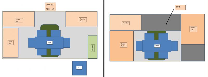

# Posted: 29 Oct 2013 04:21pm
  Here is the layout

# Posted: 29 Oct 2013 05:48pm
  Are your designs to scale? Furniture, too?

# Posted: 30 Oct 2013 08:57am
 Quoting: trollbridge Are your designs to scale? Furniture, too?
  Yes, this is all pretty much to scale.  These are the most accurate measurements I could find for everything.

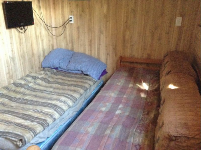

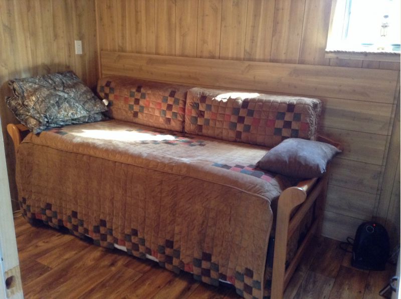

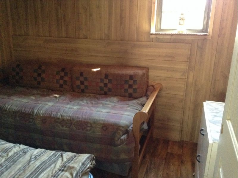

  Here is the pictures you requsted of my bedroom. It is 7'4" x 10'1". The cabin is 16x24. This was with a pre-made shed/cabin shell that we are finishing the interior. We built the loft that is the ceiling to the bedroom. Right now we have a daybed and as you can tell in pics it is pulled out and there is still a bit of leg room between beds. It will fit a full bed length wise and width wise. A queen will fit length wise only. The bedroom height is 6' 9 1/2" between the beams and 6' 3 1/2" at the beam. Also room for a 3 drawer chest. We have been well pleased with it. Good Luck with your build!  image.jpg

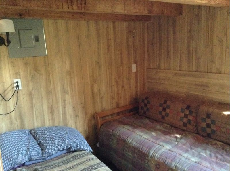

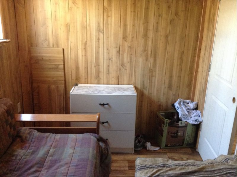

# Posted: 4 Jan 2014 01:14pm
  And here is one where we have the room made up as our TV room.
Purplerules
# Posted: 4 Jan 2014 01:19pm
  This way the kids can be watching tv and adult can visit in the main room. Works out great.
