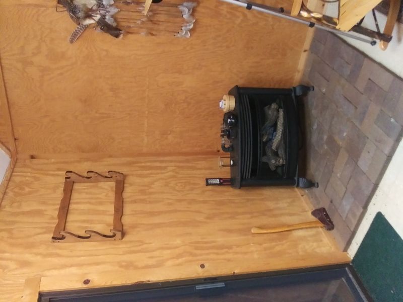

# Posted: 29 Nov 2020 12:40pm
Reply Quote
I have a similar situation the interior walls are just plain plywood. Not osb. Is it better to remove plywood or just cover it with T n G pine?
# Posted: 29 Nov 2020 01:10pm
Reply Quote
Leave the plywood unless you need the thickness of the ply as extra interior space.
If you leave the plywood you then have the option of using adhesive to mount the T&G. There is also some very thin T&G made that is easily glued; I have done that over drywall.
The plywood also acts as an air barrier, something that T&G is not so good at.
Fanman
# Posted: 29 Nov 2020 08:13pm - Edited by: Fanman
Reply Quote
Unless the cabin was built very recently, the OSB has probably outgassed all it's going to. My inclination would be to leave it in place and just cover it up.
We redid our cabin with beadboard throughout, then stained it with an exterior transucent stain. It stunk for a few weeks, but the smell faded, and we really like the result.
# Posted: 30 Nov 2020 06:56am
Reply Quote
The only benefit I see to removing the interior plywood would be to make sure its insulated properly.
