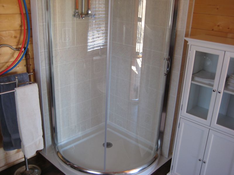

  Another question I thought of today that you might be able to help with: Since I don't have any experience with log cabins, I just can't quite get my head wrapped around the concept of the logs moving. I mean, obviously all buildings settle and move, but I realize that it takes on a new level of concern with such a structure. I've seen, or at least I think I've seen, conflicting photos which make me more confused...
  I've read that the flooring must 'float' and not be attached to the side walls at all. This makes sense to me, but as such, the wife is concerned about creepy-crawlies coming up through the gap at the edges. Also, I see baseboard trim in many photos, but I can't figure out how it is attached without creating problems.
  I saw an official installation video today that shows the flooring butting right up to the wall and base trim mounted tightly to the wall, which contradicts what I've read.
  I'll explain what I'm thinking, and maybe you can just confirm or correct me? I'm thinking that the floor and base trim CAN be connected to the bottom run of logs because they themselves need to be fastened to the floor joists, so that run of logs isn't going anywhere. It's the logs above that are going to move around... Is that correct?
  It's my understanding that anything that is fastened to the wall, be it cabinetry, shelving, showers, or what-have-you, must either be connected to one individual log or use slotted sleepers of some sort. Is that also correct?
  Many thanks!
drb777
# Posted: 12 Jan 2016 07:32pm - Edited by: drb777
  While it's true that the subfloor T&G boards are not nailed to the sidewall logs, they are firmly nailed to the pressure treated floor joists. And yes, the first course of wall logs also are firmly attached to the floor joists. With this type of structure, there is no requirement for a "floating" sub-floor or surface floor, at least with the Louman/Lillevilla products. The supplied (sub) flooring is 3/4" x 3" (approx.) T&G nordic spurce.
  On my cabin, I finished-out the floor by adding a floating laminate system (poly/foam/interlocking laminate), but that was simply optional, and done for it's practicality and aesthetics.
  Base trim to close-up the very small gap between the flooring and the walls is included as part of the package. And as normal, the trim is nailed the sidewall only, not the flooring.
  As with all log-type structures, moisture from the air during the different seasons can and will cause a bit of swelling/contraction of the walls. Frankly, these kiln-dryed and fully machined logs have negligible movement if you do the proper exterior sealing. Best I can tell, after 3 years, my cabin walls have contracted only about 1/4". As prescribed, I simply tightened the steel corner tension rods and that was that.
  And yes, verticle attachments to the walls need to account for the slight movement, but it's very easy once you learn a few little tricks. The photo below shows the corner shower I installed that did require substantial verticle wall attachment. As shown, I simply framed-up a limited corner wall providing the necessary static structure.
  These type of cabins don't really flex/move any more than any other conventional wood frame construction. In fact, considering how tightly every individual log fits at the corners and interior wall junctions, the entire structure is extremely solid and stable.  Corner Shower application

  @drb777: Gotcha. Thanks for the explanation. Based on your shower photo, that's pretty much what I envisioned, I was just confused on the flooring part. This has been a busy month for us, but after things get settled, we would really like the opportunity to see your cabin in person before we actually pull the trigger on a kit home. I will email you... maybe next month sometime to see if we can work something out?
