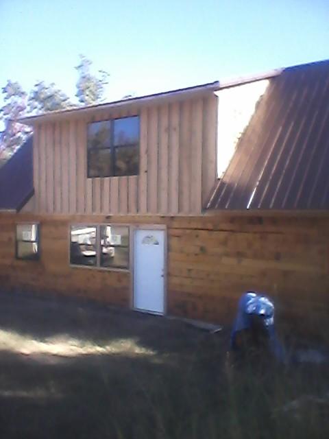

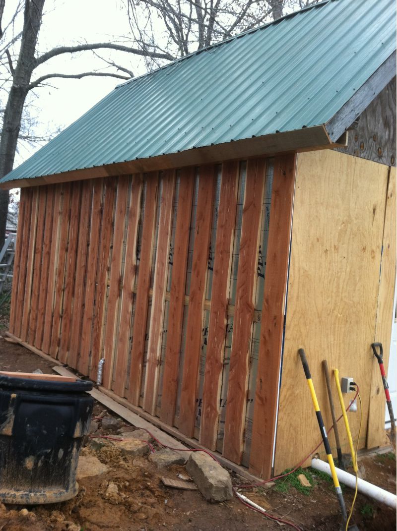

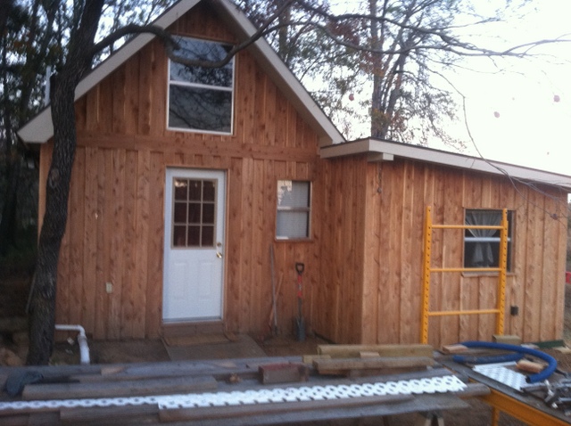

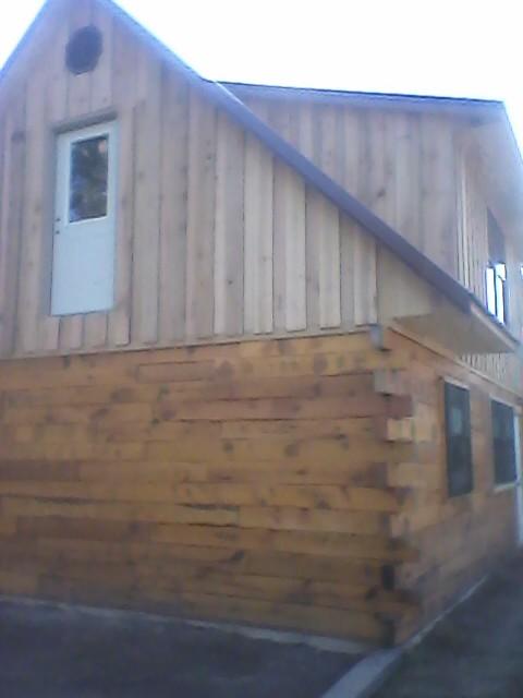

  Hello, I used both; Oak Logs and Oak Board and Batten on my lake cabin. On both materials I used Sikkens Log and Siding stain and sealer. Its good stuff, but not cheap.  Honestly, If I had to do it again, I'd frame it up, either conventional or post and frame, and use all Board and Batten. Easier to do and goes up faster. However, I'd stick with staining. I'd rather refresh every three years instead of scraping paint..ever again.
  I also used Board and Batten on some red cedar boards on our Farm Cabin, conventional framing, used the Sikkens. It really brings out the color on the cedar.  That project went much faster.  Here are pics of both.  cabin_east.JPG
