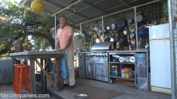

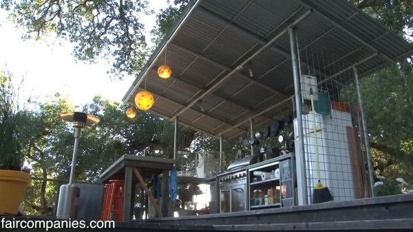

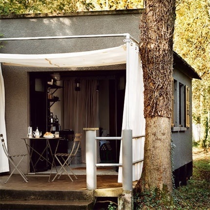

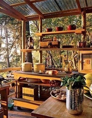

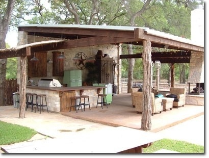

Hi RidgeRunner: I have a nice kitchen in my cabin but would like to add a outdoor screened summer kitchen. Here are some photos I saved:
RidgeRunner
# Posted: 16 Nov 2013 08:23pm - Edited by: RidgeRunner
Thanks silverwaterlady,
Outdoor kitchens are great!
I do a lot of canning and the like.....doing that outdoors sure beats doing it in a hot indoor kitchen!!!!!!

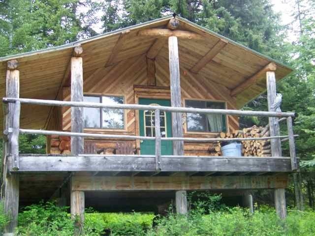

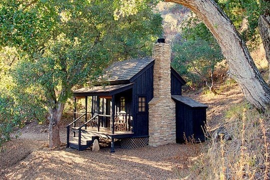

I like the design of this first cabin. The side porch could be screened in and used as a outdoor summer kitchen. The second photo is a good inexpensive idea to add a quick temporary shelter to the back of your cabin. I like the cozy cabin look of the third photo.
RidgeRunner
# Posted: 16 Nov 2013 08:28pm
Yes and I do really love the third photo!
