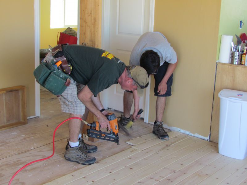

I did exactly the floor you are doing, it'll work out fine, but you must lay a subfloor. I'm old-school and not a fan of OSB (yes guys, I know the new stuff is better, just too many old nightmares) , I used 3/4" CDX, then glued and blindnailed the 1x6 pine. Then toe nailed the ends of the boards where they butt - it is super solid!
You can get pressure treated 3/4 ply nowadays, other wise, I'd prime both sides of whatever you use..
