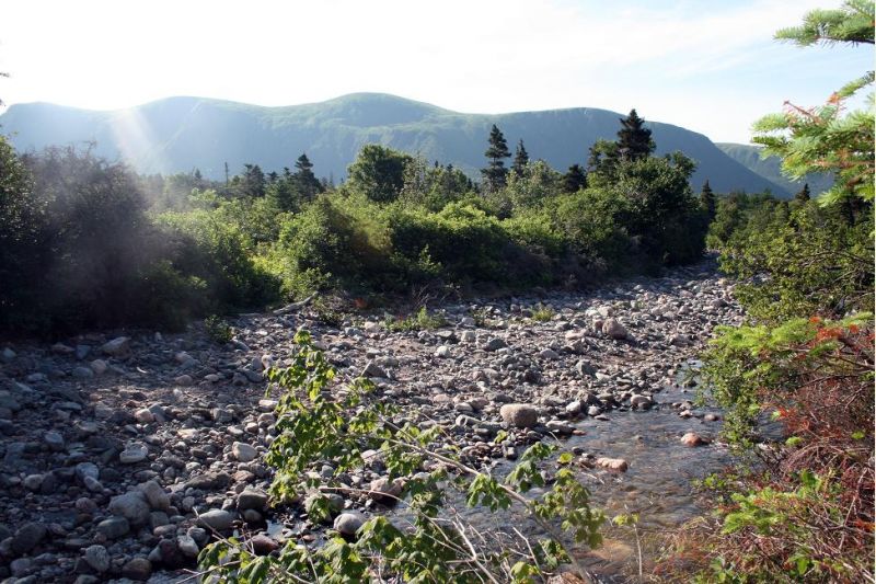

Another issue for me is about the foundation of the cabin. I.m wondering if a source of running water like the brook was nearby, does that mean I have to build completly above ground, I wanted to put in a simple cement basement to keep a cold room, and storage.
Attaching a couple of pics, I wanted to put the cabin just behind where the top person is standing. The other pic would be my view.

Nice location and great view.
I would think that the bottom of your basement would have to be above the high water line. If the creek is running in a bit of hard pan you might be able to have the basement floor at a lower level but I think that would be asking for trouble.
Others may be able to tell you if a solid pour concrete basement could resist the water. I'm pretty sure block would not.
It's hard to tell how high the ground rises above your head in the picture but you might just have enough room for a 6'-7' basement if it sticks out of the ground a little.
