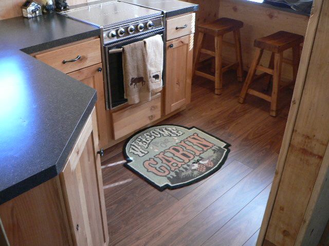

# Posted: 16 Dec 2013 11:21pm - Edited by: toyota_mdt_tech
  I used the laminate stuff, no glue, no nails, snaps together on a real thin blue pad. Simple to install, very little expanding/contracting with temps. Looks great when its all done. Its only about 5/16" thick. So it doesnt build up your floor too high either.

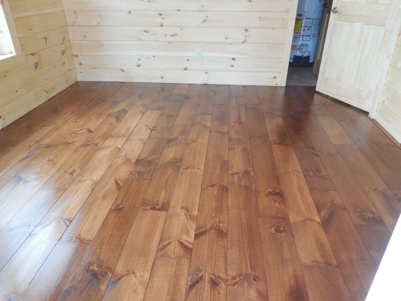

  Here is how it looks at my cabin:
  So like I said - we like the rustic look and the imperfections. I am not a fan of the 'plywood' look of wood floors... where it looks like one big pieces as all the pieces are identical and sit perfectly. Matter of taste

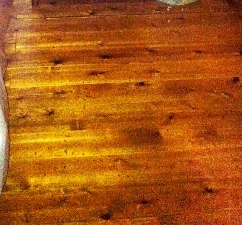

# Posted: 17 Dec 2013 09:52am - Edited by: silverwaterlady
  We have white cedar flooring milled from our trees at the local lumberyard in our loft. The cabin is off grid. It is very cold in the winter and hot in the summer. Built in 2006 and not one problem.

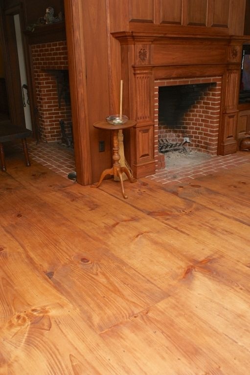

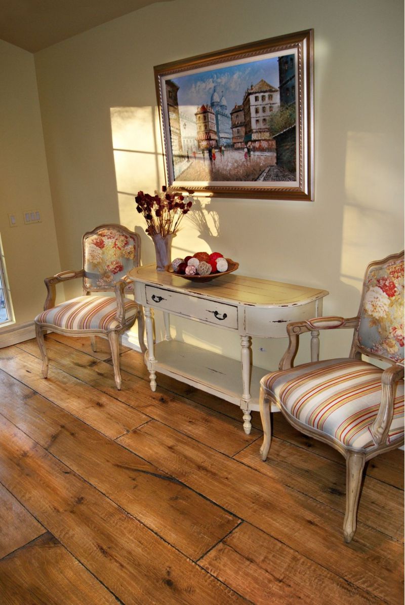

  We plan on using wide plank pine floors downstairs also locally sourced wood milled at the same lumberyard.  Cedar loft floor
  |   Projected wide plank floor
  |   Like this as well

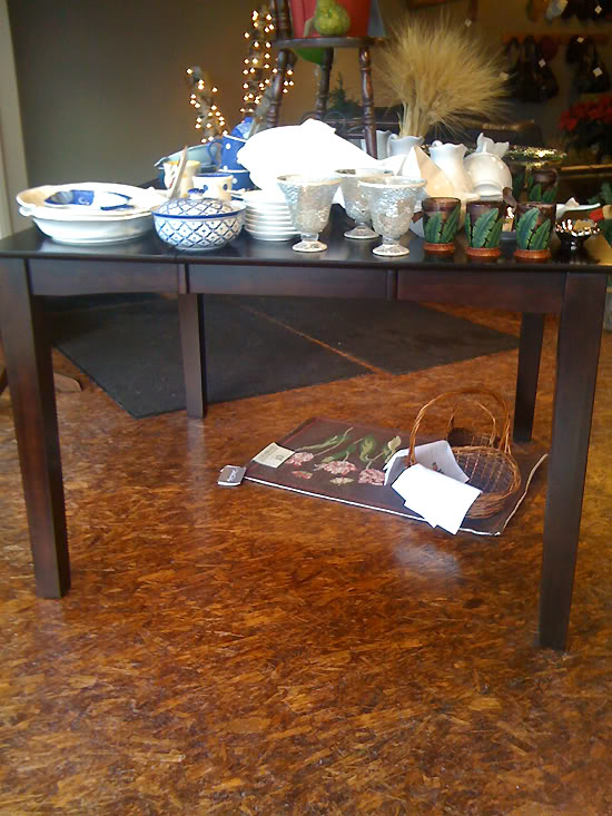

# Posted: 17 Dec 2013 12:10pm
  Really cheap wood floors OSB  sand it smooth.  They set the OSB sheets down on the floor and kept the joints super tight remember to offset the seams. (rent floor sander) then coat with polyurethane 3 times
  we did this to our 1700sq cabin. if we want to put wood floor down later we still can, this look great and you can stain it whatever color you like.
  I think this floor is brilliant. It looks great and was inexpensive.
