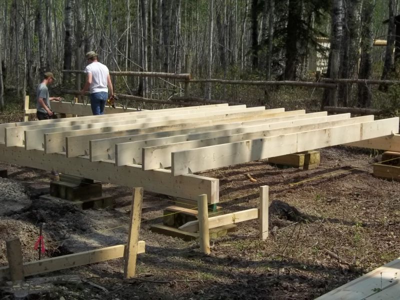

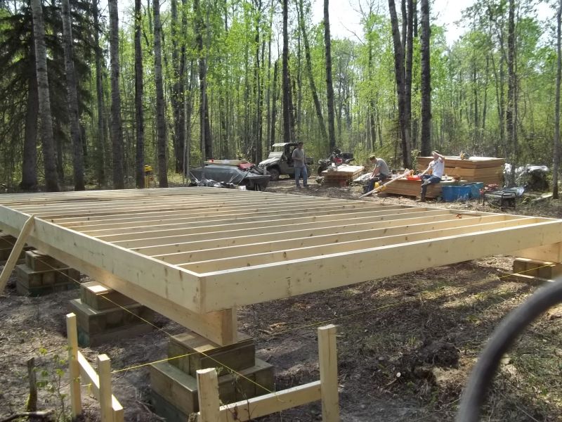

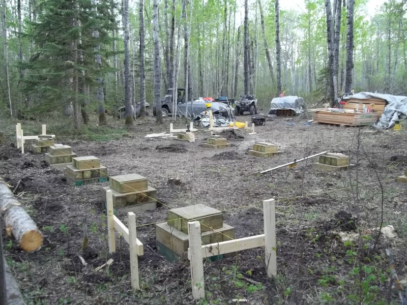

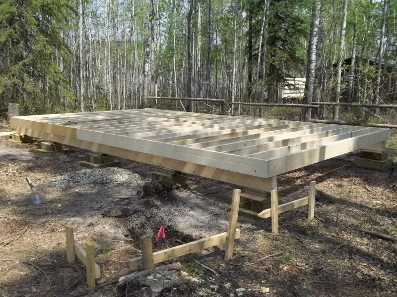

I'm just purchased a lot and i'm in the planning stages of my cabin. Do you have any more pictures of the entire foundation, floor and framing steps?
I've build sheds before, but all smaller than 14x18...so i'm just trying to get some ideas. I like the way you made you're pads for your foundation, i'm thinking of going the same way since my lot is not easily accessible either

curt Not sure if you are still around or not, however i found this old post because i'm contemplating the same elevated platform concept sitting on precast concrete pads.
Can you confirm your joists and beams are 2x10's?
Did you fasten/attach the beams to your structure below them?

I am dealing with a 12 by 16 building supported by six concrete piers which have been damaged by ice out and then high water. This is in Ontario. I plan to use some of the ideas posted to build new support. The three layer system using 6X6 and plywood on rock. How do I size the pads ? Is there any preference using 2/6 or 6/6 ? Do the materials need to be ground contact grade ?
# Posted: 16 Nov 2022 08:21am
For a 12x16 I wouldnt even put anything in the ground. Pus skids under it that are strong and put it on blocks. I have a 10x14 shed I just have 6x6 skids, did next to no site work and put each runner on blocks. It's been fine for 3yrs, havent even adjusted the door. No gravel, no digging, six 12x12in pavers and six 8x8x16in concrete blocks. Wood shims to level.
