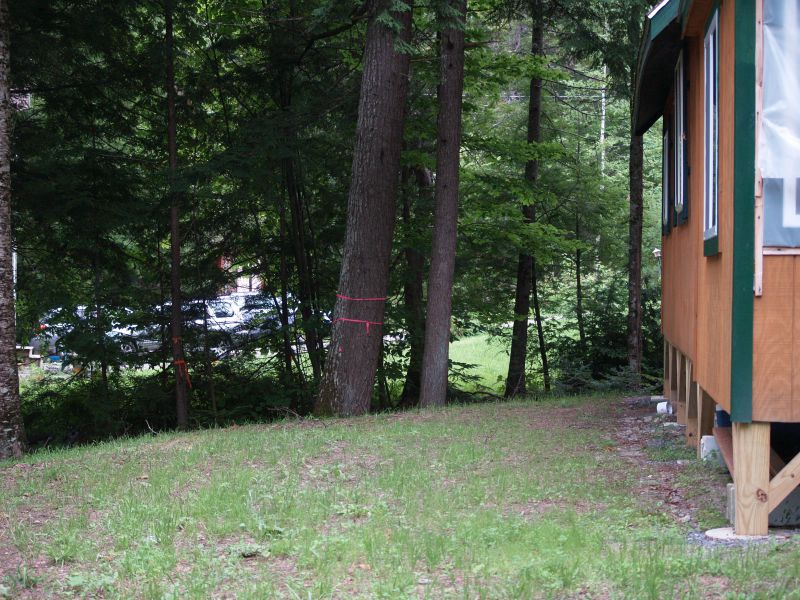

Hello,
We have a 20x36 lakefront cabin in central Maine that we bought a few years ago. The cabin was built on cement blocks. We had a cabin leveler come in last year and remove the blocks and add 6x6 posts with cross bracing on top of 24" holes filled with crushed stone and topped with engineered concrete cookies.
This year we had several contractors give us estimates for an attached deck. One contractor was going to dig 48" holes and pour concrete footers for the deck and the other was going to build the deck without footers.
So here is the question...since the cabin is floating should the deck be attached to concrete footers? Does anyone have any experience with this type of construction?

Hello, If it were mine I would do the same type footers for the deck as the cabin has. Welcome to cabin forum

x 2 I would as well

Attach the deck to the structure but keep the footings the same as the structure. Otherwise you will have a structure that moves and a deck that does not- separation will show and it will never settle the same.
If its solid keep it all solid. If it floats let it all float.

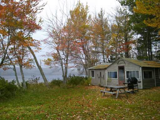

This camp is 70+ years old and in the spring the water is very close to the structure, at this point the camp structure is compromised and I have decided to build a new camp.
I mysekf have entertained the idea of a layer of crushed stone, then sidewalk blocks, then deck blocks to support the structure.
I have included a picture of what I would like to build....facing SE, looking down the lake.
