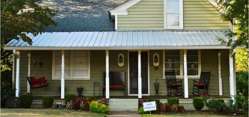

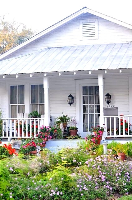

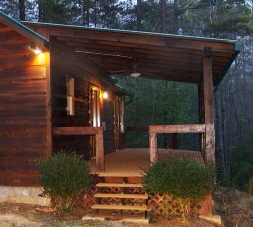

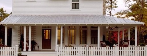

  I am not a builder so I can't help you with that. I do have a fondness for covered front porches with metal roofs. Actually,I love them! They remind me of the cabins down south.
  Here are some photos of my favorites:  image.jpg

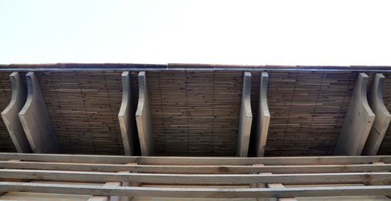

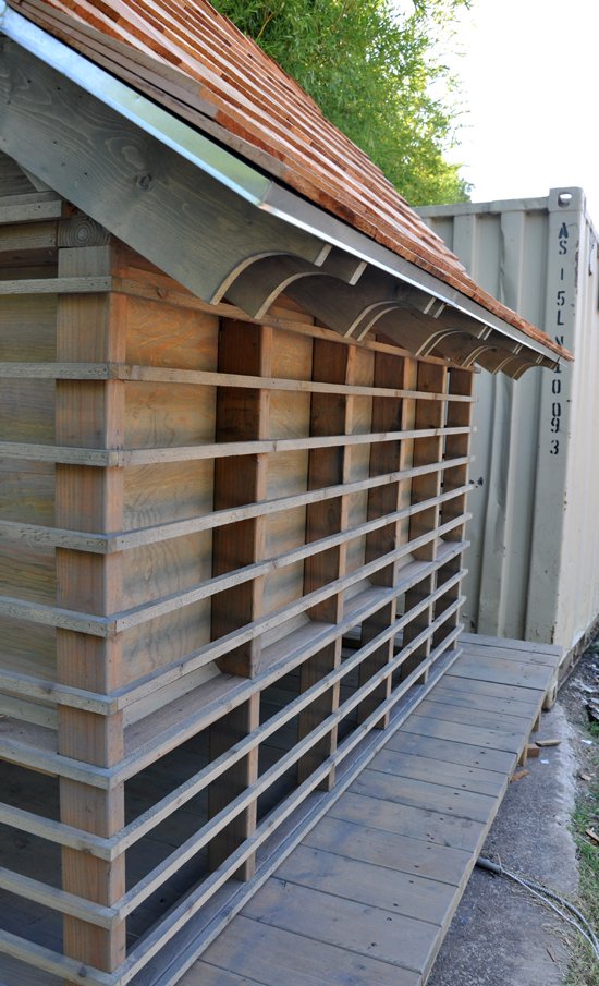

# Posted: 8 Jan 2014 08:11pm - Edited by: rockies
  These are images from a Japanese style building, but the principle is the same for my suggestion. If you have rafter tails extending beyond the porch wall supporting the overhand, attach a rafter extension to either side of the rafter tail and support the ends on top of a new beam on new posts to create a covered deck. You won't need more than two posts at the corners, but the pattern of double rafters under the roof will look nice.  double rafters
  |   double rafters 1
