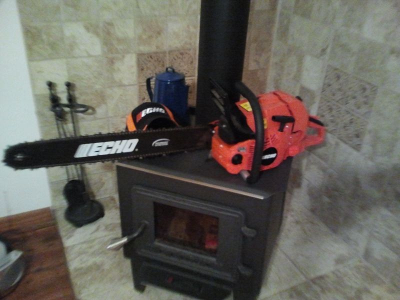

  Very easy. new guy here as.already mentioned hardy backer cement board. i put in a stove in my little farm house. i cut out the drywall off the walls replaced with 1/2" hardy backer then versabond then porcelain tile then grout. ill try to post a pic. oh [img=null][/img]nhardwood floors built a frame on the floor2x4 plywood top 3/4" thinset versabond on top of plywood.hardy  backer goes on top of versa then more versabond on top of hardy then porcelain tile and grout. goin on 4 yrs havent turned on the furnace. good luck.
