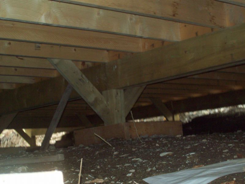

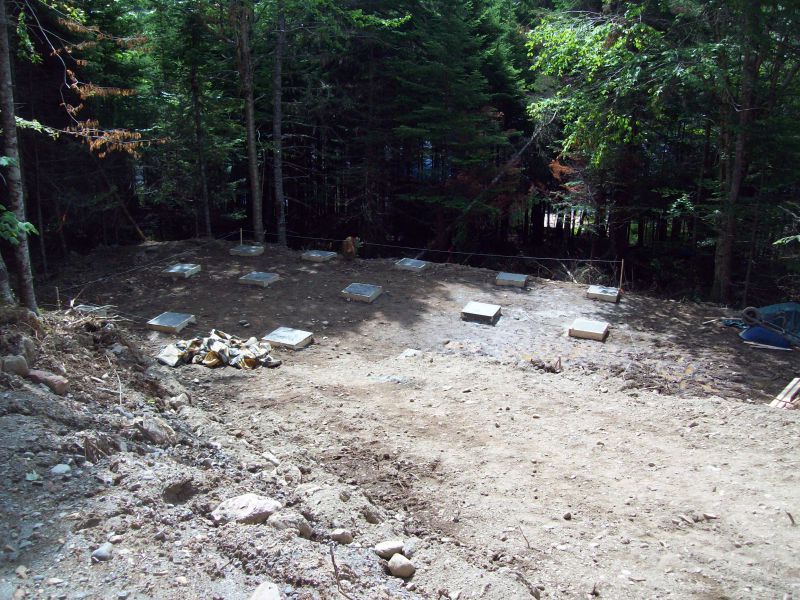

  I built my place 24x32 on 2x2 concrete pads - three rows of five pads and then used 3 2x6 posts leading up to three 2x10 beams.  On top of this I built the floor joists with 2x8s.   Has held up amazingly well with NO movement in over five years.   Bedrock should be even better for you - but I would suggest you at least use pads similar to what I have - even if you have to take it out years from now not that big a job.  And you cannot go wrong building from the a good foundation!  MacBeth_26_June_098..jpg

 Quoting: Jim in NB I built my place 24x32 on 2x2 concrete pads  What is the thickness of your pads? Do they go below grade or sit on the surface? Thanks

Jim in NB
# Posted: 25 Jan 2014 11:26am
  The pads are about 6" deep - used 2x6 for the forms - put in four pieces of rebar.   I had a pad built and put them right on top of the pad.   No issues with frost although the place is not heated in winter other than the odd weekend.
