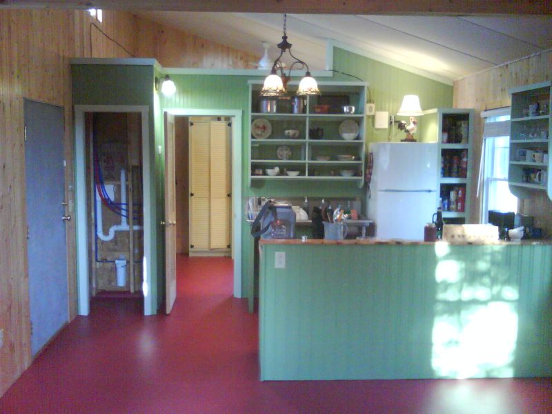

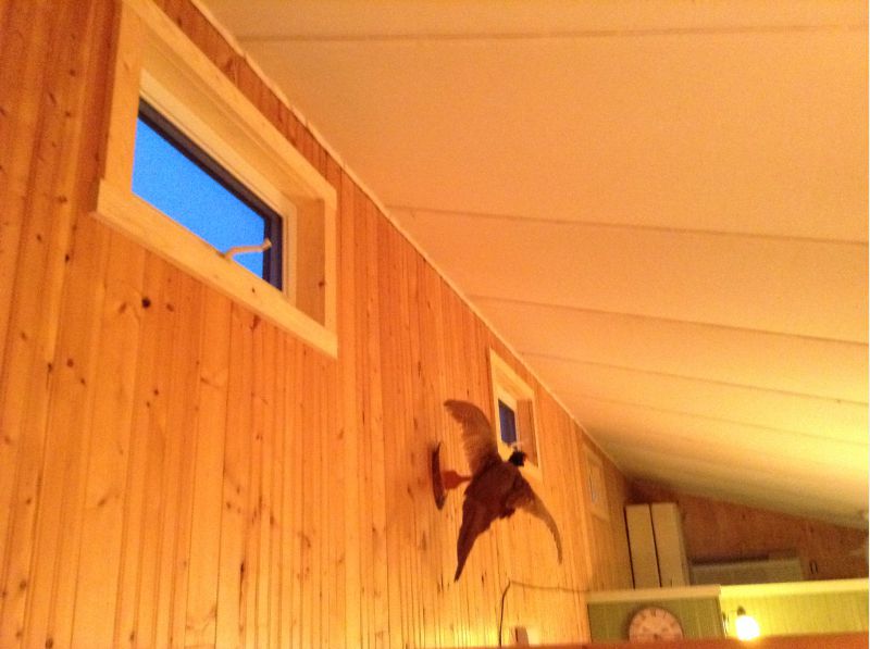

# Posted: 28 Jan 2014 05:55am - Edited by: EastTN
  Canvase. We did ours to look like a tent ceiling. It looks super cool. We screwed it up using drywall screws and folded the edge over to hide the screw heads with hot glue.  20090330_16.JPG

  Keep the ideas and pictures coming. I really like the canvas idea that looks neat.
EastTN
# Posted: 29 Jan 2014 09:00am
  its fire retardant tent canvase

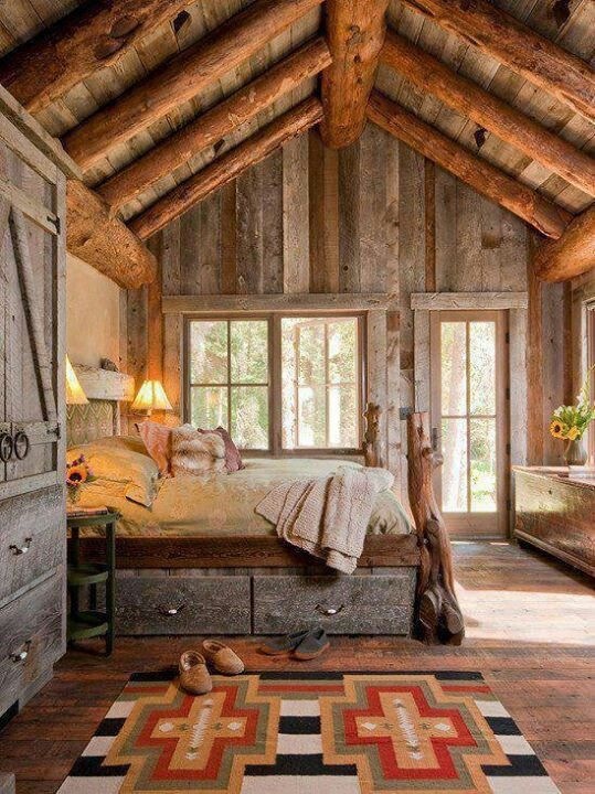

# Posted: 31 Jan 2014 10:53am - Edited by: silverwaterlady
  I like the look of this cabin ceiling. This is our first choice so far....
# Posted: 31 Jan 2014 02:42pm - Edited by: trollbridge
  EastTN, I like your canvas ceiling, too. I also like your red floors! Fun place!

  Nice job! That had to be a lot of work to keep straight, and overhead, too! Any idea how long it will last? Are you concerned about mold or stains?

# Posted: 31 Jan 2014 09:15pm - Edited by: silverwaterlady
  I've been doing some research on the wood for our ceiling project in the above photo and how it can be done inexpensively.
  Barn wood is not a option since its to expensive. Rough sawn cedar from the saw mill is cheap in our area It can be aged with a solution of steel wool soaked in vinegar.  Dark cold black tea is brushed onto the wood first and allowed to dry. Than the strained vinegar/steel wool mixture is brushed on.  The iron and tannin in the tea react giving the wood a weathered look.  I will do a sample piece this summer to see if I can get the desired effect.
   I am going to experiment with different tones as well since I don't want the wood to be one color. The longer you soak the steel wool the darker the stain will be,using cider vinegar will give it a darker tone,eliminating tea on some boards they will be lighter, etc....
  I don't think we will seal the boards because I want them to continue to age.
toofewweekends
# Posted: 31 Jan 2014 11:37pm
  Silverwaterlady: Agree on the look, but (off-topic) I wouldn't put a window under the ridge beam. I'd like a log going to ground!

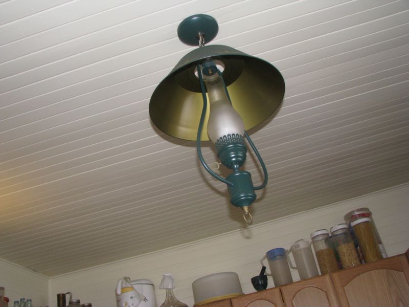

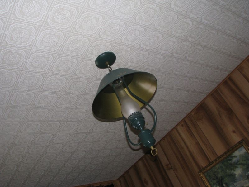

# Posted: 2 Feb 2014 12:42pm
  We absolutely LOVE our ceilings.  We have this in our bedroom and also our motel rooms.  They are acoustic tile that we purchased at Home Depot.  They give the look of tin but are not dark like tin.  They were fussy to install but we like the effect.
  The other ceiling photo is of the front room of our cabin.  It was installed a hundred years ago and is tongue and groove cedar.  It is the original ceiling from 1912.  Acoustic tile
  |   100 year old cedar

  EastTN - Your place is AMAZING!!!
