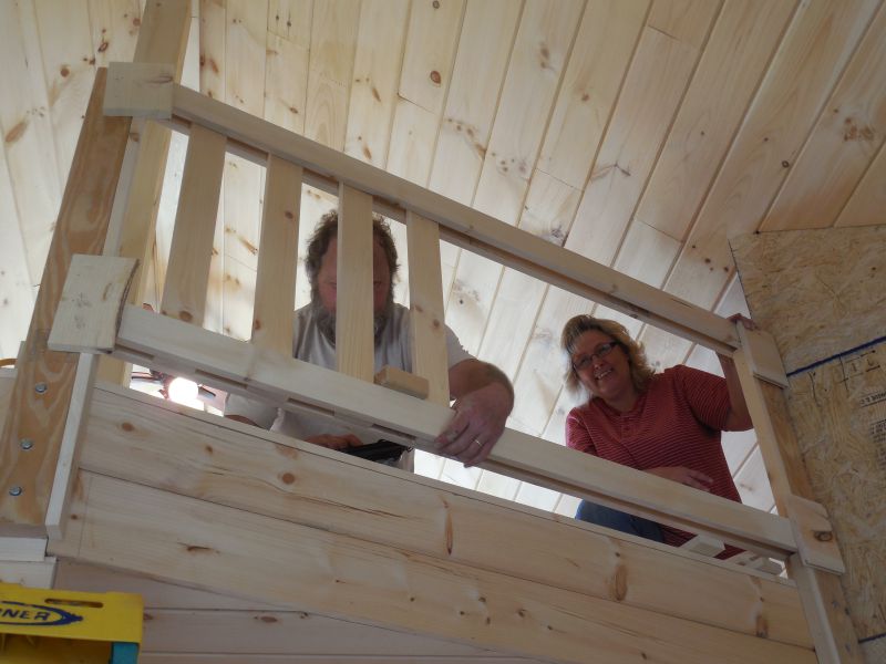

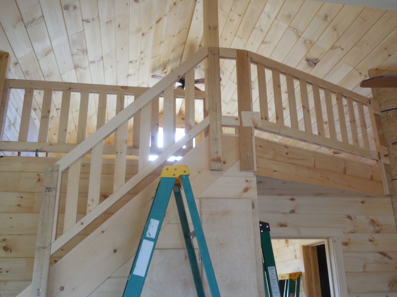

Our loft rail (see picture below) was constructed of 2"x2"s and 2"x3"s, ballisters spaced with a 2 x 4 (~3.5" spacing). Cut and drilled and sealed all ballisters at on-grid home to install at off-grid cabin. Cut 2 x 3's to length with old-fashioned handsaw, assembled everything with cordless drill and 2 batteries. Got it all done between breakfast and lunch IIRC. Note this loft has low ceiling and I just wanted to keep sleeping kids from sliding off, but concept could easily be stretched for a higher ceiling.
Could do the same with cedar ballisters left outdoors to age a bit or stained for a rustic look. There are some pretty fancy ballisters to be had at many big-box hardware stores.
Another member purchased a BEAUTIFUL wildlife scene metal casting from Menards and made that his loft rail http://www.small-cabin.com/forum/6_1441_5.html#msg39151

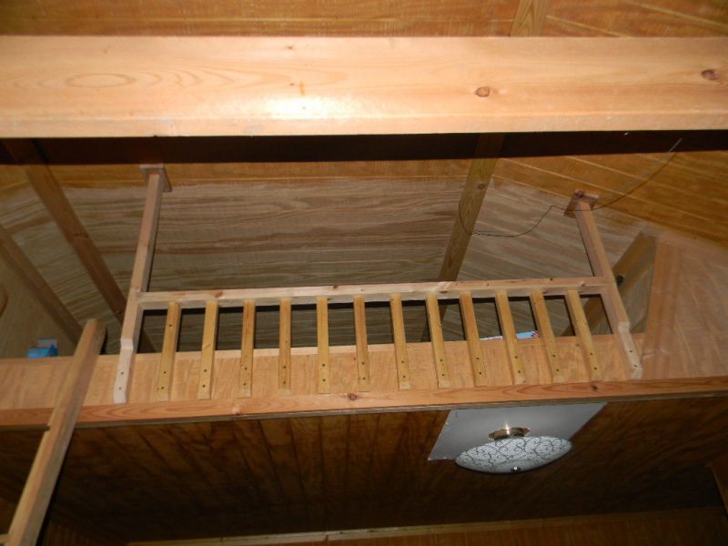

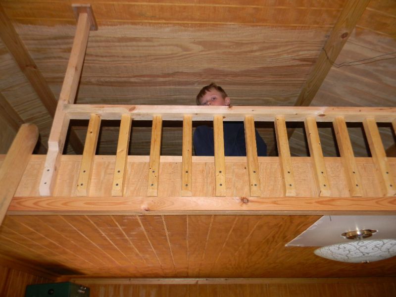

Here is one way it has been done using aluminum deck spindles spaced 4 inches apart to "fill in" the loft railing. In this picture ignore the fish panel being upside down...it isn't anymore That was just a little oopsy that happened when getting rushed at the end of the weekend.

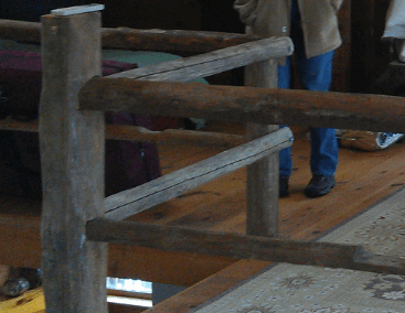

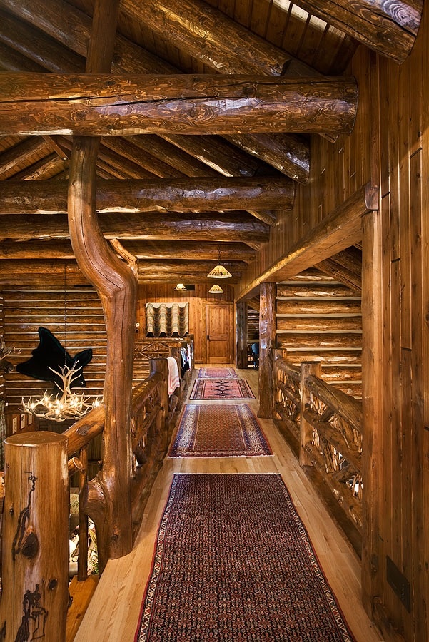

I've saved photos for awhile. I really like the look of these railings for my log cabin:

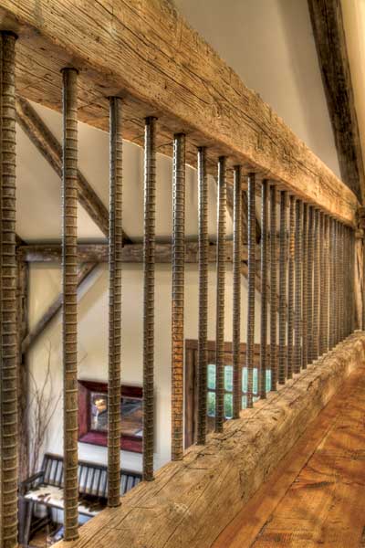

How about rebar. I think it looks great.
