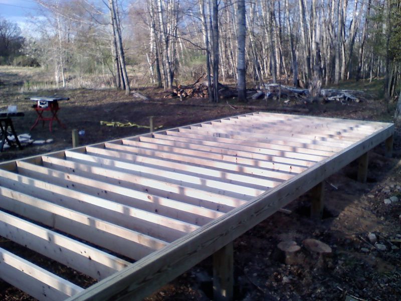

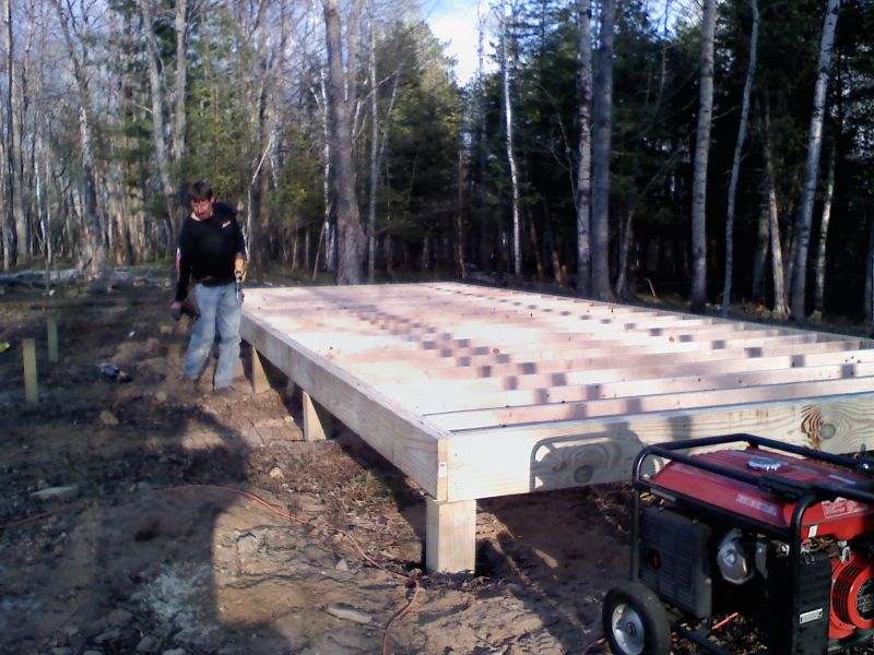

your perimeter boards should be a doubled 2x8 or 2x10 because they will be carrying the weight of the cabin when you connect the joists. so the question is do the blocks accommodate the with of the doubled 2x8? and remember the longer the span the bigger the the lumber size. my cabin is 12x32 framed with 2x10 joists and the joists span 12' without support but on the perimeter the supports are 8' apart 0508091938.jpg
