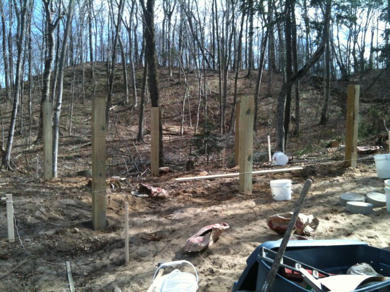

  I'm building a 12 x 16 on 12 6x6 posts with three built up beams of 3 2x10s, on top of the posts. Used a water level to get post tops level.

  How did you fasten the 6x6 posts to the ground? Concrete form?

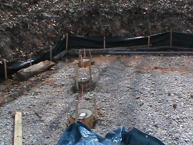

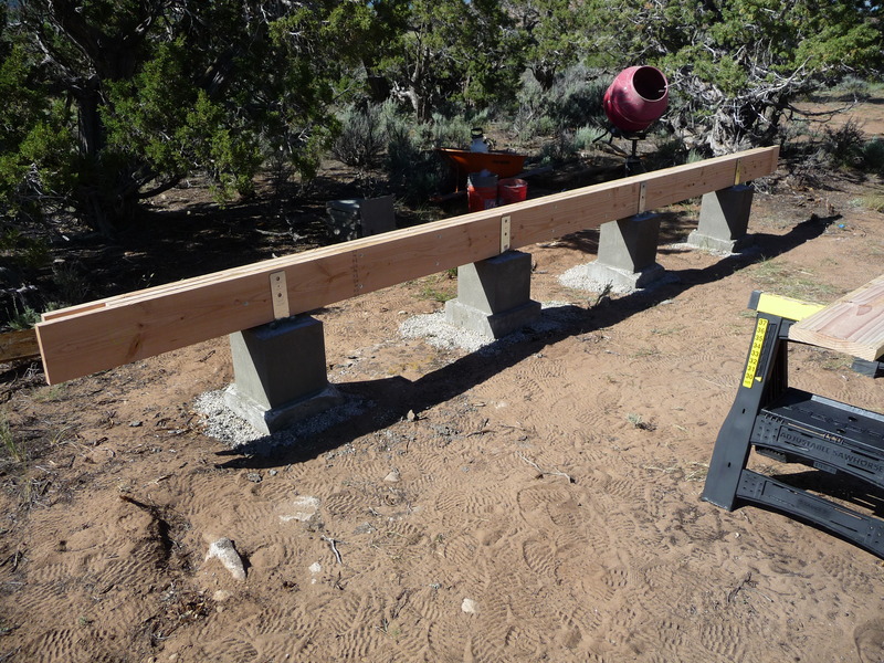

  C_Spon - I set my beams directly on top of the piers with the appropriate brackets. It can be hard to get the top of the piers level, but can be done with a string line and level along with sonotubes.
  I had a sonotube that shifted before being poured and ended up a little low - so I used some non shrink grout below it after i had the beam level.

  Looks great! Hoping I don't have too much trouble getting everything leveled!

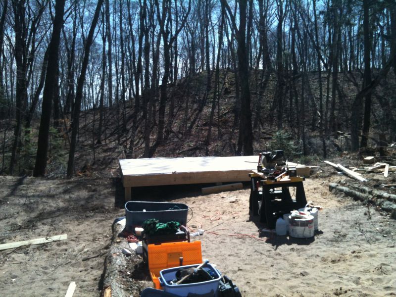

  I built my cabin on PT 6x6,s and used my transit to make sure all 9  posts were notched at the same exact height.I checked on all 9 places where the posts sat after the main framework was done and everything was within a 1/4 inch of each other which was good enough for me.It,s all in the math seeing as every hole is a different height to start with.I do a lot of decks so I have an idea of what,s happening.I would always use 6x6,s.We notch the 6x6 3 inches to receive a double bamboard for the outside perimeter and then carriage bolt it all together.Have fun.mongo

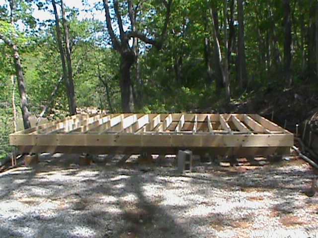

  I built my 12x16 on 6x6 posts.  6 around the perimeter set in concrete and 3 sitting on conc cookies down the middle to keep the floor joists stiff.  I nailed (with giant twisted pole barn nails) PT 2x12's around the perimeter and used 2x8 floor joists.  I went about 3-4' down with the perimeter posts.  My site was 100% sand (back of a wooded sand dune 700' from Lake Michigan).  It worked great.
