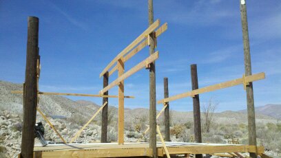

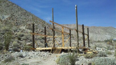

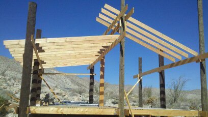

 That's what I did,too.

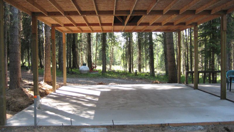

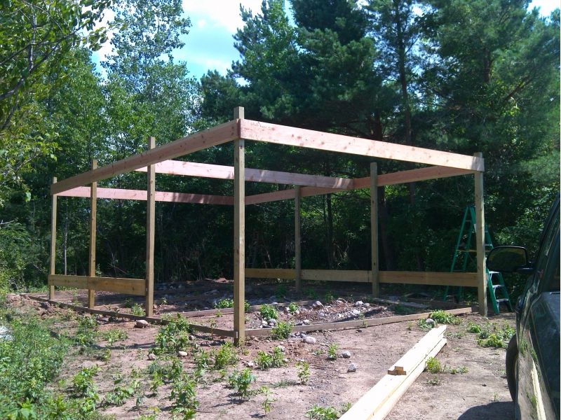

 Sorry for bumping old threads I find in searches, but it's not like the stuff is irrelevant these days.....
 What am I looking at here in say the second & third picture in the post above.  Is the roof resting on something added on top of the poles?   Or is the roof resting on what has been attached to the side of the poles?
 If building a deck in that manner is considered bad news, it can't be good for a roof.
 Or am I missing something, it's hard to tell.

 Just from looking at the picture, to me it does look like boards were attached to the sides of the poles at the top.  It looks like it was done on both sides of the pole and then the space in between filled to look like a beam.  I’m no expert or even an experienced builder but I agree that would be iffy for a live load floor.  But it might be okay as it isn’t a live load.
 It will be interesting to hear what the experienced members say.

 Quoting: socceronly Or is the roof resting on what has been attached to the side of the poles?
 Yes, it's resting on the 'girders' that are bolted to the poles. There is one girder inside and one outside. He will do the same for the floor (if he's using a floor, most pole barns did not)
 Quoting: 95XL883  It looks like it was done on both sides of the pole and then the space in between filled to look like a beam.
 No, it wouldn't have been filled in typically.
 Quoting: 95XL883 I’m no expert or even an experienced builder but I agree that would be iffy for a live load floor.
 Actually it's fine, these structures are unusually strong and what's more...flexible.
 Rayyy did not use poles, but he is building this the way it is done. Here're some pics of the cabin I built with poles, it is really a great method of building; faster, cheaper and structurally sound.
