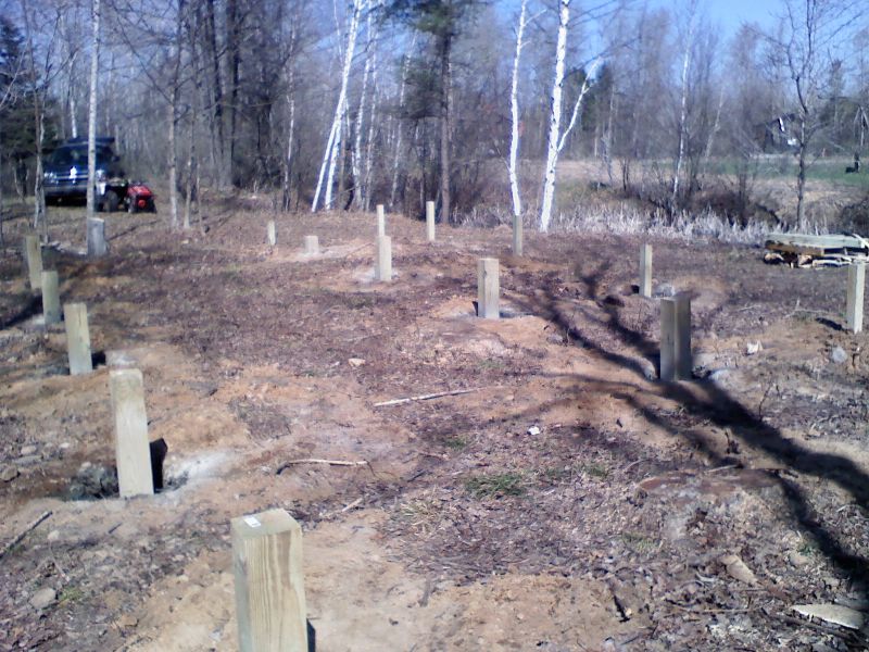

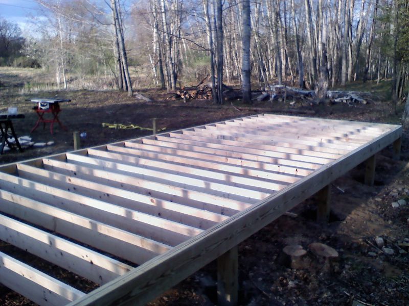

  rut, where are you building in the north or the south? i am in northern mi. and i only went down 3 ft. so far no problems.  0503091106.jpg

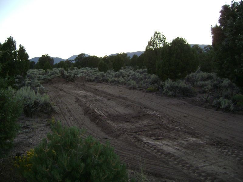

# Posted: 16 Apr 2010 08:03pm
  1st pic is of the site where we are going to build the cabin. The rest of the pics are of the ranch.  misc09_057.jpg

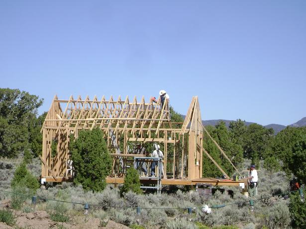

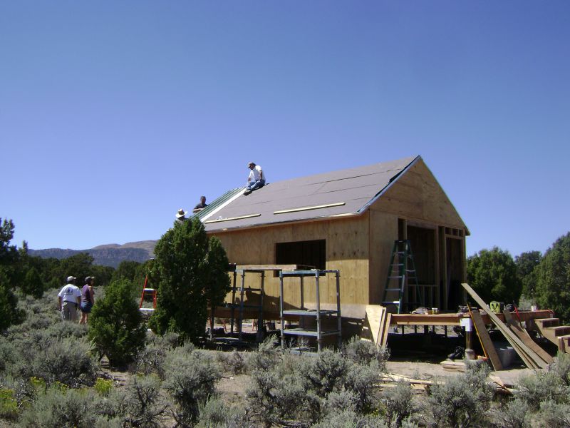

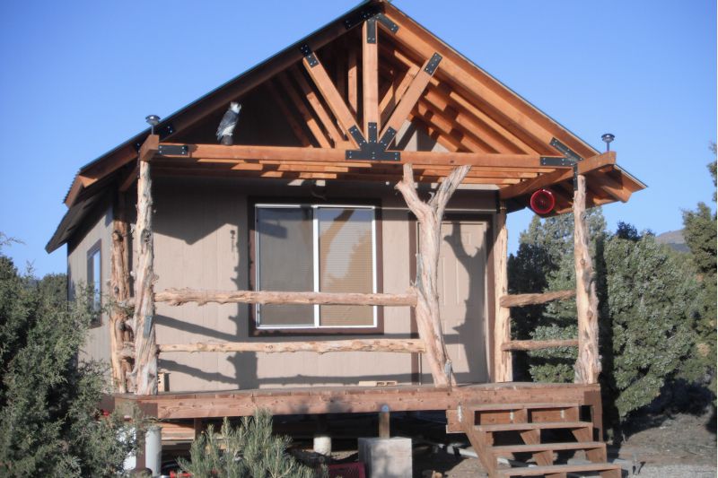

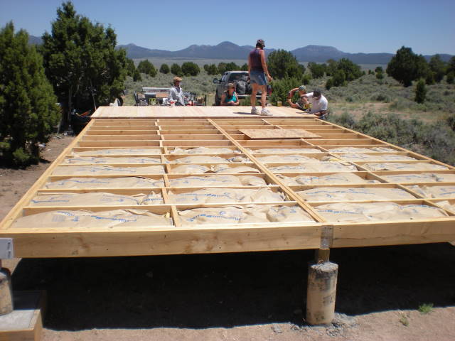

  Sorry we have not posted any updates recently. We can say been busy! We are close to being complete  flooring
  |   Walls and trusses
  |   Roofing
  |   Porch
