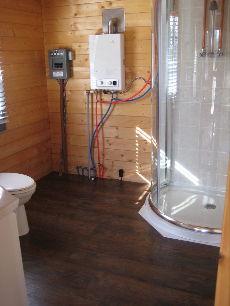

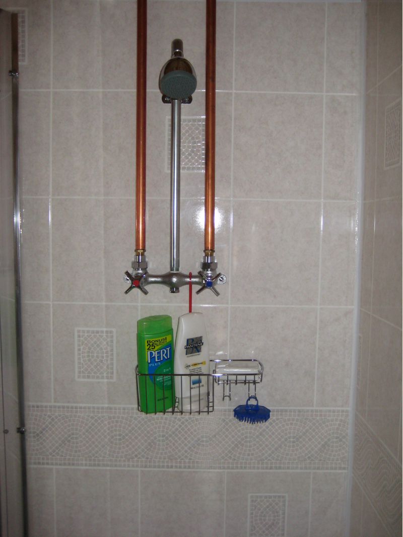

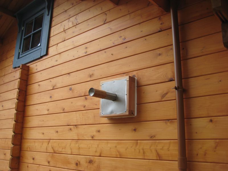

  I choose the eccotemp with power vent, natural gas, but LP is also available. Stainless vent fittings were included, 'only had to add a relief valve and normal hook-up fittings. The photos show the pex piping which may be eventually shrouded and the outside of the vent.  I was able to find the unit at a sale price of only $225 a couple of years ago, a bit higher now. This model does require AC power, but at a low level easily achievable with a power inverter in a pinch.  ecotemp with power vent
  |   external vent
drb777
# Posted: 9 Mar 2014 10:35pm - Edited by: drb777
  The model shown is a Eccotemp FV112-NG,  74,000 BTU, 3.6 gpm rating. They are now available under $300 delivered, also as a propane, LP unit. www.eccotemp.com shows all of the different units they offer, lots of choices.
