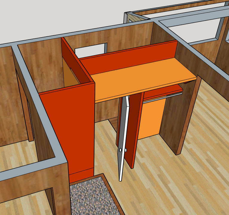

  The bathroom/closet walls and shelves are a little trickier. The image below shows the plan--the red and yellow are doors. Haven't figured out how to join them, but I'm thinking angle iron brackets would work and could look sort of cool, if done right.
