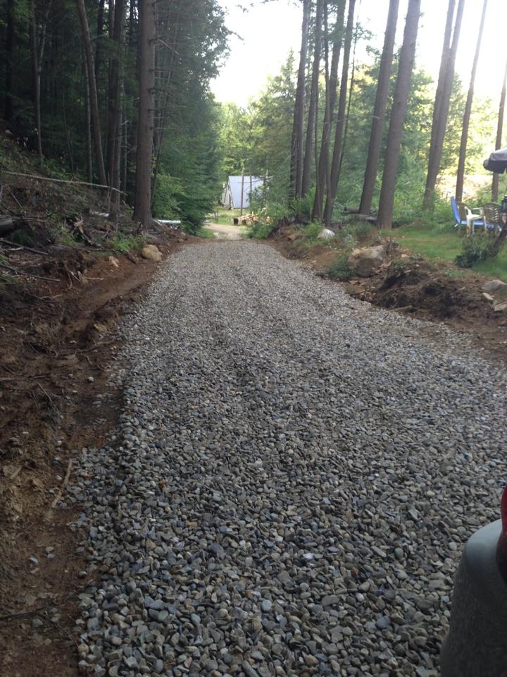

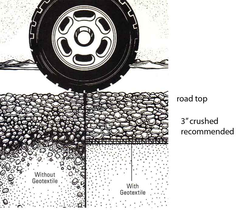

  I highly recommend using geotextile fabric anywhere the soil gets wet. Otherwise the truck/car traffic will push the stone into the muck and your money will slowly sink away.
  I built a 900 ft laneway. With 750 ft using geotextile. The laneway went through pure farm muck. 1500 was for geotextile fabric. 1500 for crushed aggregate. I brought in aprox. 160 tonnes of stone.
  The steps are: * clear organic material (for me that was 6-8 inches of topsoil) * roll out geotextile (it was available in 12 or 17 foot widths) * pour and level a layer of 3" aggregate 4" deep. * top dress with 1-2" of roadtopper (1.5" and smaller with fines)
  Every area seems to have a different name for the stone. But 3" minus and road topper were the names in my area.
  Using crushed aggregate allows the sharper stone edges to lock together making a better road. Round gravel may not hold as well.
  I call it the "30 year" road. After 3 years it still looks like the day it was finished. I have not had to scrape or level.
