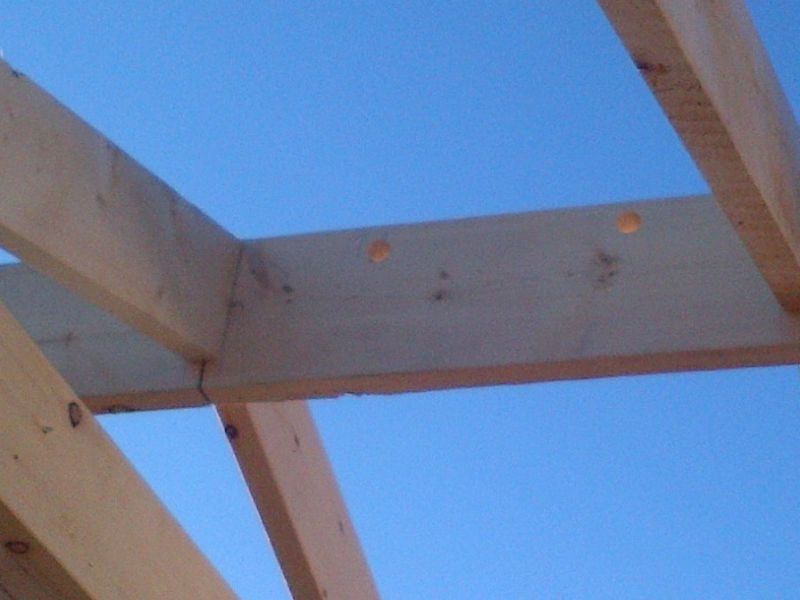

New to this forum, I've learned a lot of cool stuff so far. I am building a 16x20 cabin with open roof concept (cathedral, no flat ceiling), and I have a 2x8 ridge beam with 2x6 rafters, and doubled collar at every 4 ft. My plan is to soffit vent screened hole at soffit between the rafters, and also drill 2 1" holes at top half of the ridge between each rafter. I will use 3 1/2" fibreglass insulation so that will leave me with 2" of airspace between uper roof sheating and insulation. I figure that with our cold, long, dry winters and cool/warm summers, and with the winds that we get, this should be more than sufficient to allow adequate air flow / moisture escape. I live in arctic canada, way up north, and again with the winds and snow that we get, I dont see a ridge vent working, it'll get clogged and/or fill the roof with snow. So i figure as long as I got adequate are flow/movement in between in/out between both soffits between each rafter, that should work just fine.

Even with the holes in the ridge blocks, you might not get the cross ventilation that is needed, because as Don said the warmer air tries to go up and has no way out. If you are concerned about water/snow intrusion into the ridge vent you could get creative making a custom designed ridge vent that is wider, thus making it harder for water/snow to get in. Have you seen the plastic gauze stuff they make to go in ridge vents? Lets air thru, keeps out critters.
4-1/2" thick polyisocyanurate rigid foam insulation is manufactured at that specific thickness for use in 2x6 cathedral ceilings such as yours to maximize insulation while still leaving the 1" air gap required. Gives roughly R30 value, and the foil faced acts as a moisture barrier, helping that much more with the condensation issue. Expensive stuff though.
I've seen cathedral situations where they did not put in a ridge and, like you, we're depending on cross ventilating from soffit to soffit, up over the top and thru the ridge block holes. Don't know how effective it is, but in your more extreme climate I'd be inclined to go the extra mile and incorporate a ridge vent at whatever cost.

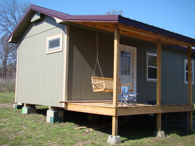

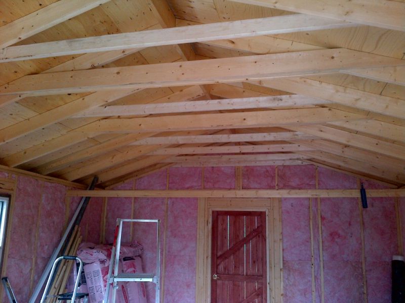

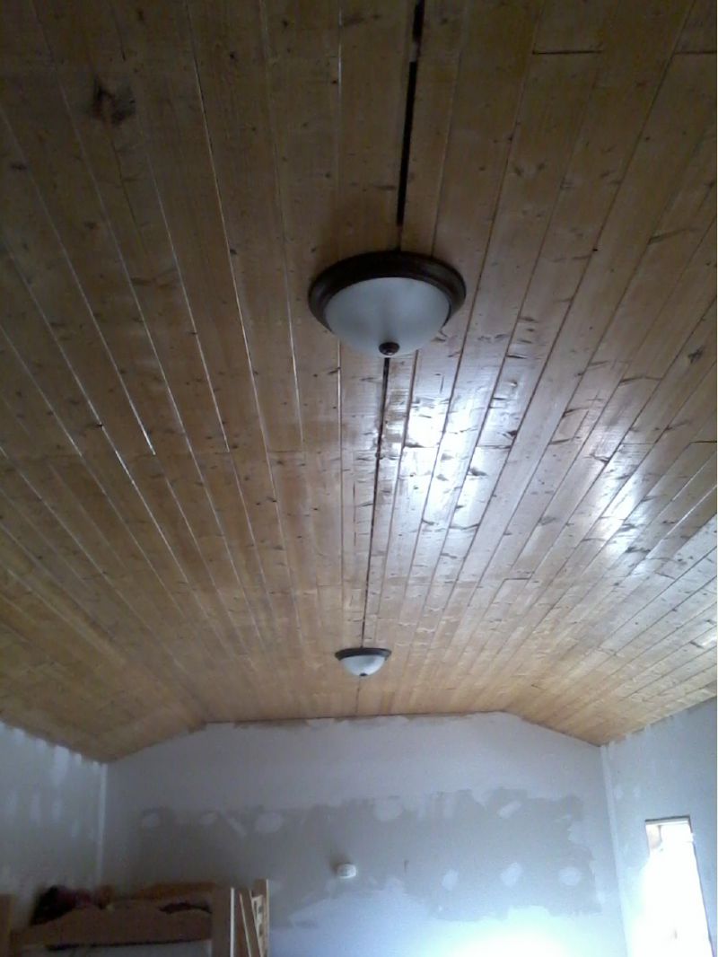

not sure others thoughts but the way we did this was to use foam insulation baffles at the eaves that allow air to pass up from the soffit vents and between the baffle and the roof decking on the slopped section of the ceiling. We were able to use r-19 still on our 2x6 rafters though it is more compressed at the baffles. We also have an 8x16 gable end vent at each end it is boxed so it pulls air up from the bottom out I could feel air moving from it while we painted the outside and this seems to be working good for us right now. The pic of the baffle is not our cabin, but you can see the box out at the eave in the pic of the cabin and the ceiling pic ours to show our ceiling line inside. baffle.png

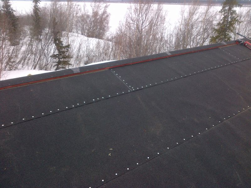

# Posted: 5 Aug 2014 03:24pm
After all this discussion, i have built a ridge vent, stained and covered with roll on roofing. It'll take some travelling for rain or snow to get in, so i'm happy with this. So with the soffits breathing, holes on roof ridge as I explained in this discussion, and with this custome ridge vent, i think the roof should breath well. I did finish insulating and sealing with 6mil, acoustic sealed all the joints and taped overlap ends throughout. so i'm confident ill have no problems. Thanks for all your input and ideas folks!! ridge vent
