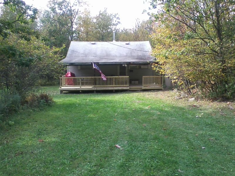

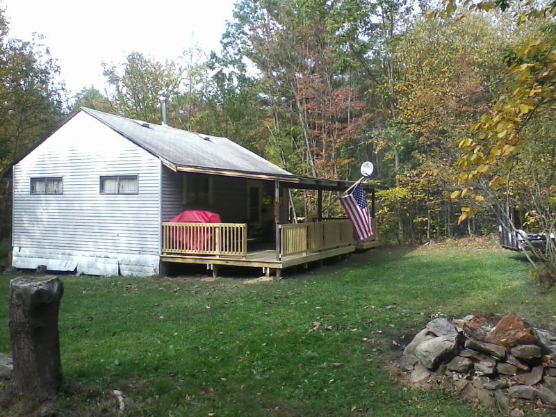

Here are a few pics of the new deck
Front View
Front View
Side View
Side View
