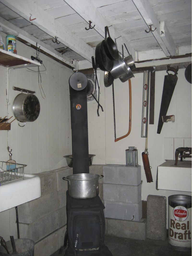

  Can I liguid nails foam  insulation directly to my osx plywood ceiling.  My roof on top is stick on snow and ice.  I don't use the camp much, but the ceiling sweats without any in the winter.  the builder never measured the rafters gap so it varies from rafter to rafter.

  That is the front room of the cabin.  I am actually insulating the back room.  The rafter situation is the same.  I just don't have a picture of it.  There is no attic.  It is in this order.  Rolled roofing over osx particle board, held up by rafters, that are not spaced equally apart.

  that is rustic. looks great.
  you could cut in polyiso foil covered foam sheet and then paint that. Maybe put up a 4x4 sheet of some metal sheeting on the rafters where it's over the stove. with that pipe probably a good idea anyway. that'd fit. oh wait. it's the back room. well. never mind then.
  for the foam sheets: trimmed roughly to fit. couple dabs of silicon to hold em up while you spray foam the edges to lock it in place. then  paint. There is fire resistant foam spray.
  I did something similar with my studio. I trimmed my foamed edges with a knife afterwards to make them look more uniform. each to their own.
  it's not code. but. cough cough.
