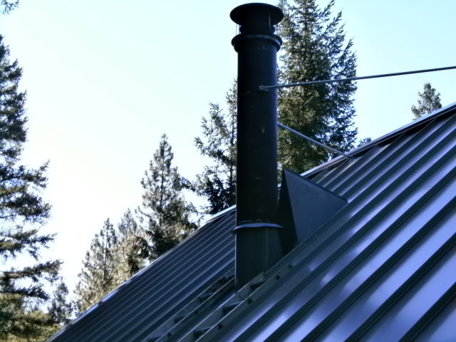

  If I ever had snow trouble on my metal roof, I'd go with something like this.

# Posted: 29 Apr 2014 03:39pm
  Look up sno jack. Or build your own. A wide chunk of stainless flatbar, sharpened a bit (optional) laid on its side and gusset it on the uphill side of the pipe. It will slice the snow in half and it will pas right around the chimney. Have good pipe supports on the top also.
# Posted: 29 Apr 2014 06:14pm
  Locate the chimney as high on the roof as possible, so that a minimum of snow can accumulate above it. Snow slicers work well with fresh, soft snow, but if the snow sits, melts a bit and freezes into a clump of ice then you have a slow moving glacier tugging at your chimney and slicer both at once. In this case the angle iron idea mentioned above may work well to hold the glacier in place, if the iron is securely bolted.
  But a chimney 2 feet from the ridge won't gather enough snow to be a problem to begin with, IMHO
