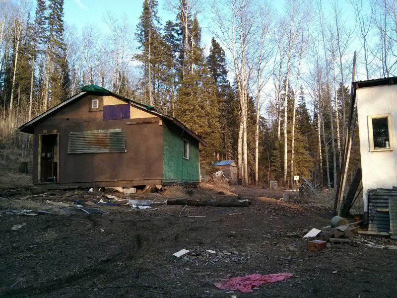

  It's just that the joists on the lengthwise north side of the cabin are almost in the soil, and the lengthwise south side is a foot off the ground. It's relatively level on a slightly sloped ground, but it could use a slight lift.
  So with access under the building being a potential task I'm now thinking to pull the floor out. Both to remove the flooring and insulation, but to also prepare for being able to get underneath the cabin for raising.
  I dunno. I'm trying to be as diy as I can. I don't want to hire a consultant or a carpenter. I don't think I can easily raise this from the outside only

  Terrible picture for now is all I have
# Posted: 5 May 2014 08:11pm
  Maybe pulling the floor is the right thing for you to do, but here's a suggestion that might avoid that. Usually when they floor jack, they place a beam under the joists and perpendicular to them to support them all, then jack the beam. Even if you pull the floor you'll have to do this, since it does not make sense to jack individual joists. Point is you can dig just enough to get the beam in, then get under the beam in two locations only, and start jacking. Maybe you will have to pull the floor to get the beam in though, if the joists are close to the dirt. Wise of you to lift it up, I only hope the joists are not rotted.
# Posted: 5 May 2014 08:21pm
  That's a pretty good picture for getting a sense of what you are doing. I guess the joists run lengthwise down the building, from what you said. I bet they are not continuous, probably lapped in the center which means you will need three beams. Otherwise you could possibly lift it just from the ends, which have easy access to place the beams.
  Looks like you got some nice straight trees there, so getting the beams will be no problem.

  The joists run width wise. It's hard to tell if they are lapped or meet at the center. The joist furthest back seems to be one piece. The joist closest facing the picture looks like it might be two pieces.  Seems a little odd.
  So you think I should try to get two beams the full length of the cabin under there? Or just get under three joists? There could be some boulders in the way. I'm not sure yet.
  I suppose even if I were replacing the floor, that keeping it in place while raising retains some stiffness or integrity?
