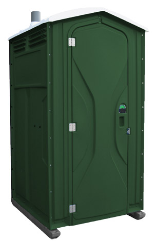

# Posted: 8 May 2014 09:15am
Quoting: dpoisson
Howdy!
I'm building a simple outhouse for our hunting camp (composting toilet aka "toilette sèche". 4' square, single slope roof, with a place to sit and that's pretty much it.
I bought one of these brand new.
http://www.satelliteindustries.com/products/outdoor/portable-restrooms_tufway.php
I used green on the sides. You can pick different colors or combos of colors. Its fly tight, vented, urinal, screening, door hing with hardware, toilet paper holder, vent stack, opaque roof to keep it lit up. Total cost was $699. And required no labor. So total cost was a wash. Hardware building one etc can make it spendy. For me, this was super easy.
Mine was called the Tufway 150
