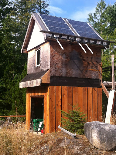

soundandfurycabin
# Posted: 23 May 2014 02:15am - Edited by: soundandfurycabin
Canadian building codes typically exempt accessory buildings less than 10 m2 in "building area", where building area is defined as "the greatest horizontal area of a building above grade within the outside surface of exterior walls". So, they don't add up the floors but they do take the measurement where the area is greatest. And yes, that does mean you can go 2 storeys, subject to any height limits in the zoning bylaws. Local jurisdictions might modify the rules though, so you should go in and ask for a copy of their building bylaw.
