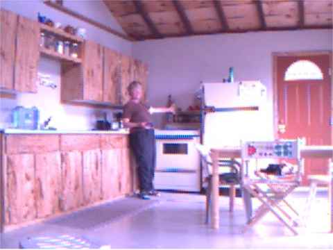

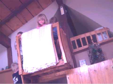

# Posted: 17 May 2014 07:10pm
Here I used 2 2x4 #2 spruce nailed together and stained brown before I raised them as rafters on 24 in centers . I used 5\4 x 12 barn pine as roof deck ,also stained it clear coat before it went up . I think it made for a nice look but to each there own .

Just: wow. Very inspiring! Thanks.
