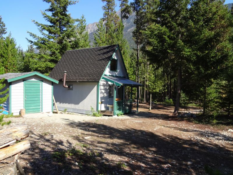

  Hi! New to site... just bought a small 12 by 16 cabin in BC, needs a lot of work, have started with the roof as I am needing to fix the chimney, noticed that that rafters are only 2X4, I have re-insulated and vapor barrier with R14 roxul but no gap for any ventilation.
  The cabin gets a lot of snow in winter and we will be using it occasionally year round... I was told the 2by4 rafter was not a big deal as the roof is a steep 12/12 pitch; however, I am concerned about ventilation, I am putting a metal roof on and was curious if I could just add a grid of strapping above the sheathing and tar paper and let the metal roof vent through the ridges in the metal panels?
  The pic is the original cabin
