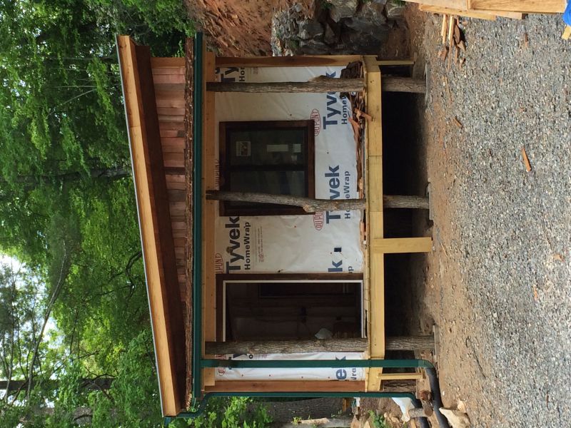

# Posted: 24 May 2014 10:33pm
  This is what we have going:
apray
# Posted: 24 May 2014 10:35pm
  Oops, sideways.
